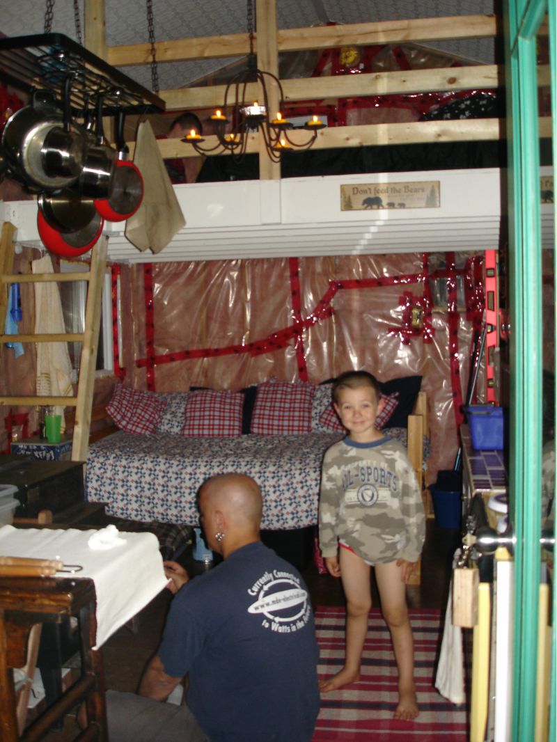

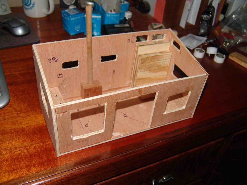

 we built a scale model out of some scrap 1/4" thick luan...it helped with the layout inside etc.  I also used it as my "plans" by pencil sketching stud / joist layout etc. Tori and I just used it yesterday to mark up our lighting layouts...(she has not been to the cabin since I started building about a month and half ago).  I added a foot up to 11 on the short side...(about 20 extra sq feet for not much more material) Back wall at 10' front at 8'
 after I got the rough framing done I tweaked the loft height to sit on the front window header...this is about 4-5 inches higher than the original plan...the height in the loft took a hit but the "walk around height below seems right"  Also the dinning area is a bit smaller than than the model so we get to have a "storage closet/ bath room (sawdust compost) after I built the "seats" and saw the extra space....living in the space while building gives tons of insight on stuff (like our light locations...having a 3 way to serve the ladder for in and out of the loft...was something that I thought of after using the space)

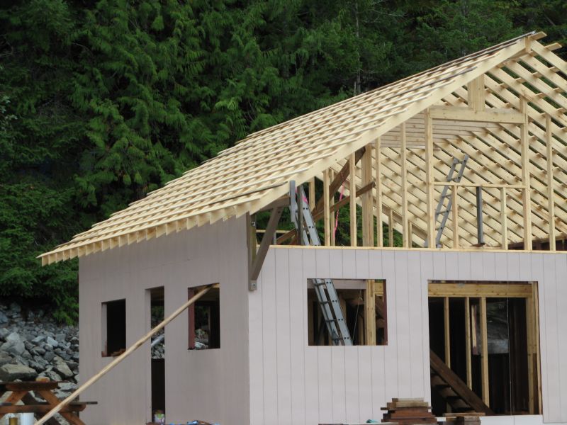

 Our friend is building a new float cabin. He also wanted to have more head room in the loft.  He chose to make the side walls 10' but the front and back 8'.  You can see more about how he has been constructing at my blog under Float Cabin Construction.
 Here's a picture that shows the walls. - Margy

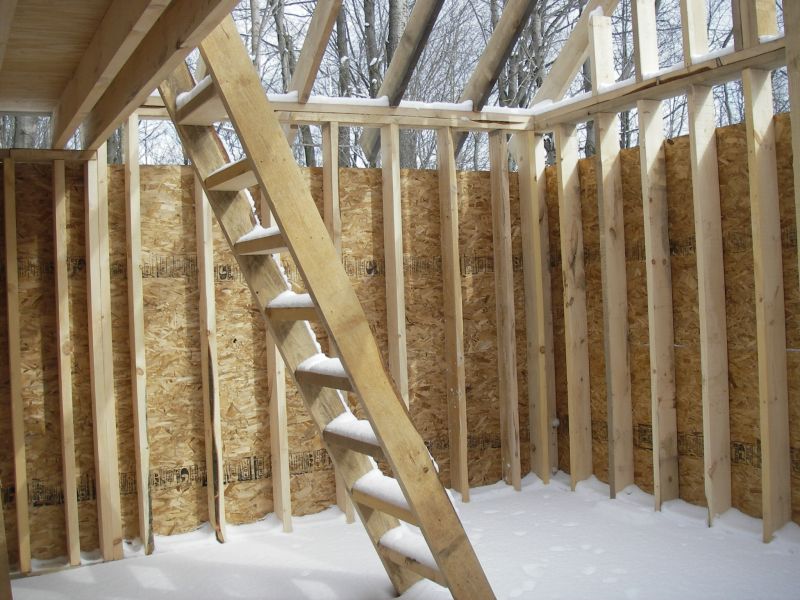

 My cabin, not including the outside deck is 16x24. The picture below (during the 2007 build) shows my 9' walls. The measurement up to the bottom of the loft floor is about 5-6" less than the 9'.
 Vince

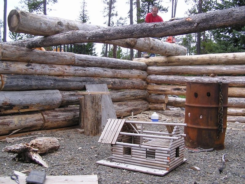

 Scaled models are an excellent idea and well worth the time!  If you have lots of snow, consider that a 10' wall will allow you greater roof overhang without blocking views out your windows and allow you to get the snow farther away from the sides of your cabin as it sluffs from the roof.

 Quoting: elkdiebymybow Scaled models are an excellent idea and well worth the time
 Hey, I see your bleached model. Your model is a "butt/pass" corners, but your real cabin is the saddle notch. ???

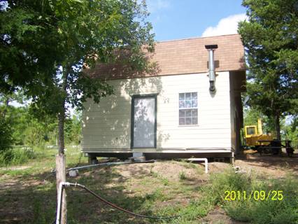

 | # Posted: 28 Jan 2012 03:25pm - Edited by: TomChum Reply
 I think 10 foot walls on a 12x16 would look tall & skinny.
 Here's a pic of 9 foot walls on a 12x16.  Log cabins are usually squatty, this one looks too tall to me - but that allowed larger eaves, which has benefits too.
