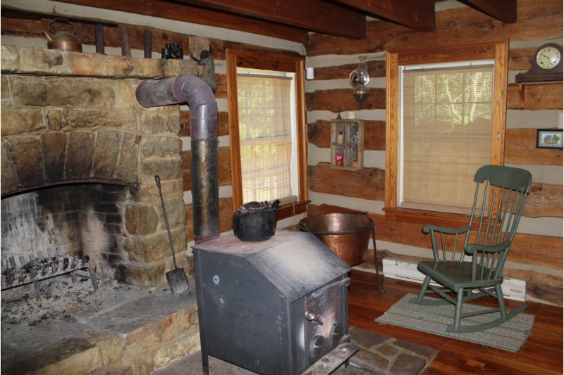

  I just got a quote from a chimney sweep to bring my wood stove liner up to code.  He said that it would cost $2868 to insert a liner in the existing flue.  This is my first time having a cabin, or a wood stove.  Am I being robbed?
  Here are pictures of the fireplace and wood stove

  Hard to say.  Does this include a a fireplace insert to replace the existing woodstove?
  Your place looks awesome.  When you have a hearth that cool, real rock and all!!!  it is a shame to have that stove sitting in front.  If it was me I'd use a fireplace insert that can be opened to look like an open fireplace (when necessary) but for heat you would close the doors and run it as an 'airtight'.  I'd do it myself, thus can't really assess the $2868 estimate.

  as I understand it, the chimney has 2 separate flues.  One for the stone fireplace and one for the wood stove.  The chimney guy said the liner in the flue was not up to code so he wasn't allowed to clean it (otherwise if there was a fire after he touched it, then he'd be liable).

  Anyone have suggestions for cleaning the soot off the front upper area of the fireplace?   (See picture in the first post above)
groingo
# Posted: 4 Dec 2012 06:48pm - Edited by: groingo
  Dish water, detergent and a scrub brush.
