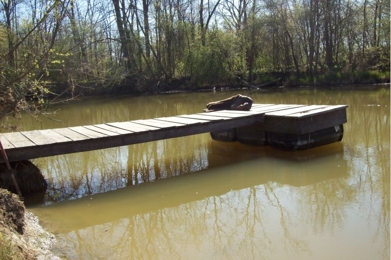

# Posted: 28 Jan 2013 09:27pm - Edited by: Just
Built this one about 5 years ago .I think it is 15 ft total length .made from 1x6 oak and 3 2x4x16s oak cut from the bush. three plastic drums and some galvanised straping. + a handfull of bolts. If you add 10 gal. of water to each drum it makes the dock much more stable.I take it out every fall and store it high and dry. it is quite heavy, but we have a large tractor and loader .. I pump out the water before I lift it out. it is attached on shore by a chain and dead man and at the water end by a chain and 3 concrete blocks .there is about 6 ft of water at the end of the dock . because we are on a small river not a lake we have currents in the water and needed a dock that could ajust itself to changing levals and currents

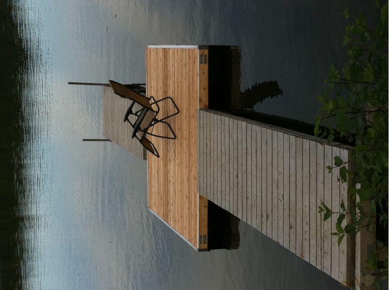

I went with a floating dock because our lake will rapidly change depth (fed in part by a small hydro dam). I did it in stages starting with two 3'wide 12' long sections hinged together. I later added the 10x10 center piece. This was a raft kit from Costco that I bolted 2x6 (I think) cedar strips to the ends to strengthen for the hinges. The manufacturer did think this would work fine given the limited waves on our lake. To reduce sway you can make out two poles at the far end that are driven just into the bottom. This reduces movement but allows the dock to rise/sink. I do split it back into the three sections and pull it out each winter. Not easy but I can do it by myself.
