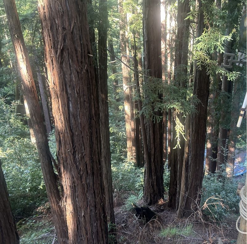

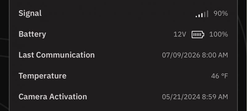

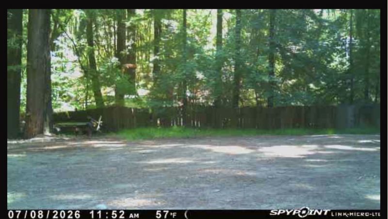

My camera is wired to the cabin battery bank via 200’ of wire. It has a 12v jack already on it. Triggered photos and a daily check photo are sent to my phone via cell. Nothing going on in the yatd today.

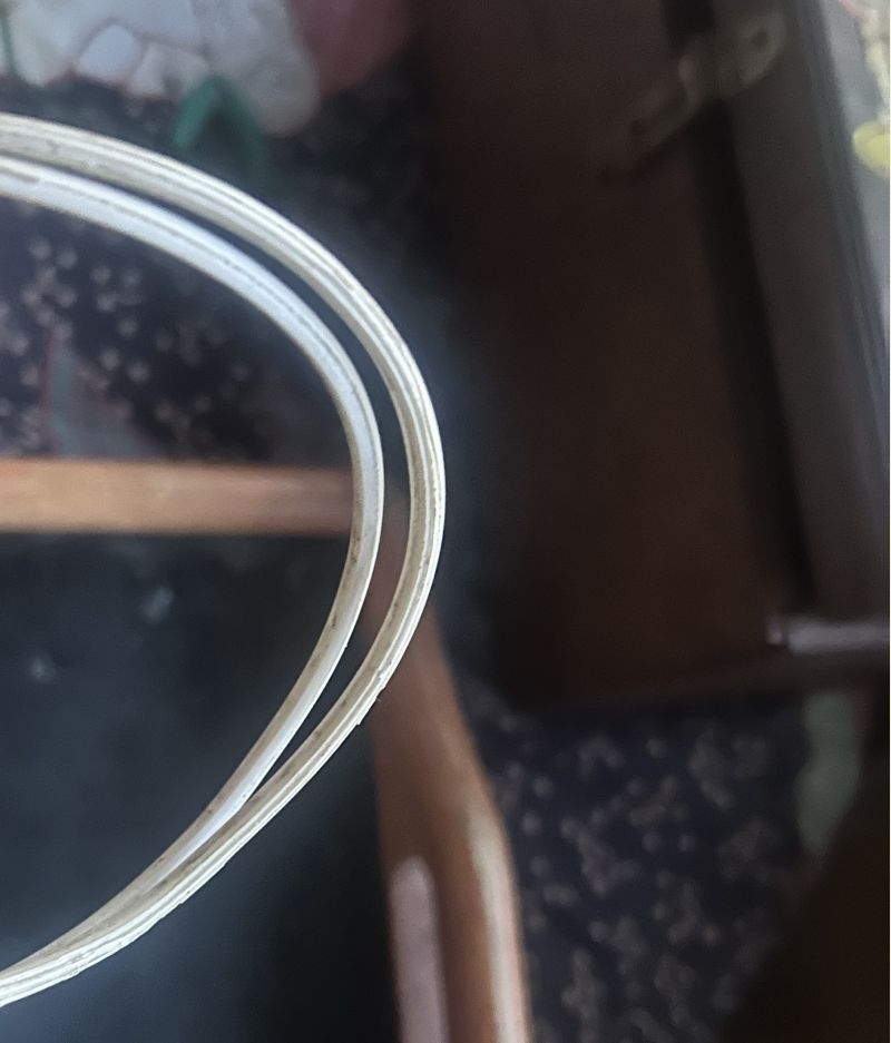

What gauge and type of wire are you running for 200'? There is a voltage drop per ga. and length of run (actually both directions) but a camera uses so few Amps that your losses are not affecting it.
Copper multi strand, 14g I think. probably is losing some juice. The cabin bank is LFP though, always above 13v. The camera status shows voltage at 100%.
