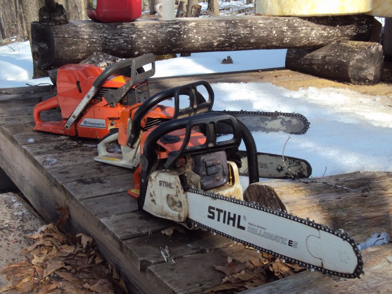

 I would be hesitant to buy a 100 dollar saw.  I purchased a used Husky that was 97cc; I gave 600 bucks and that was a great deal.
 I have three saws, I use them for felling, timber framing, and log cabin building, each has it's use.
 If I was to use only one for general use, I would make sure it was 60-70 cc and to get a Stihl, Husky, or Jonsered, I would have to plan on spending 300 dollars or so.
 Nothing beats a reliable local saw shop if you are in the market for something used.
 New 60-70 cc saws, you will be spending 500-600 dolllars.
