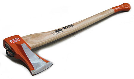

 Axes are for felling trees; mauls are for splitting. There are many designs but one with a head like the one below are the best. I like a good fiberglass handle though.
 Maybe a steel splitting wedge would be a good idea if the trees are large diameter
 You don't need any of those other items. If you are splitting in the same spot all the time a length of large dia log with one end buried a foot or more in the ground makes a good splitting block.
 For this year I'd split right now and stack bark side up. For the next wood I fell the trees in fall or early winter and cut to stove length and stack in the round. Age a whole year and then split when nice and dry. OR cut in fall/winter and split when frozen, that's easier than wet non frozen wood.

 It will perform you will just regret how much easier to cancel the order before it shipped.  use your car to drag the whole logs to the area wher you will be splitting and stacking.  dont cut a muddy log your sawchain will be dull in 3 cuts.   the maul ICC showed is better they dont get stuck like the old style with flat sides.
| ICC Member
 | # Posted: 29 Apr 2013 01:35am Reply
 that's why i showed it. not all mauls are equal. i should have explained better but thought the picture was worth a thousand words.
  i got mine years ago at a True Value hardware store. the wood just flies apart when struck with it. and yes, dirt is a chain killer. ise use smaller logs on the ground and place the larger ones across them if possible to keep up out of the dirt.
