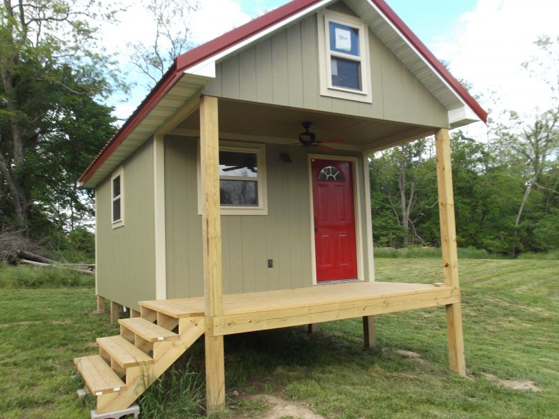

 I've got close to $8,000 into my 12x16.  That also includes my outhouse and shed.  Here are some pics from an older post.  It's fully insulated now.  I probably have another $1,000 to go with paneling and chimney materials for the woodstove.

| toyota_mdt_tech Member
 | # Posted: 14 Jun 2013 12:41am - Edited by: toyota_mdt_tech Reply
 Figure about $40 per square foot for finished inside. Less for just the shell.
| missouriboy Member
 | # Posted: 11 Jul 2013 07:14pm Reply
