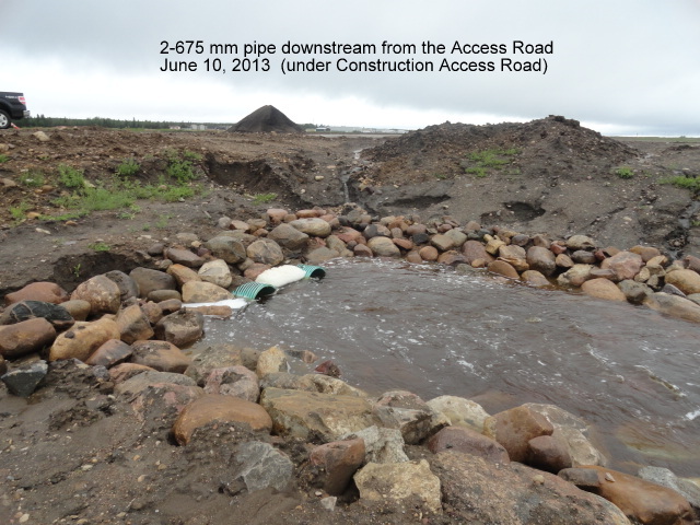

| Oilerfan Member
 | # Posted: 11 Jun 2013 10:50pm Reply
 Interestingly enough I was onsite today for one of my projects that is experiencing some flooding. The rip rap is doing its job!!!

| creeky Member
 | # Posted: 12 Jun 2013 09:33am Reply
 oilerfan thx for the pic. my buddy has a culvert that keeps "humping" up. i don't think the culvert is rising up? but it potholes in the road before his culvert, then humps, then potholes... any suggestions for him? is there a minimum depth of gravel to go overtop?
