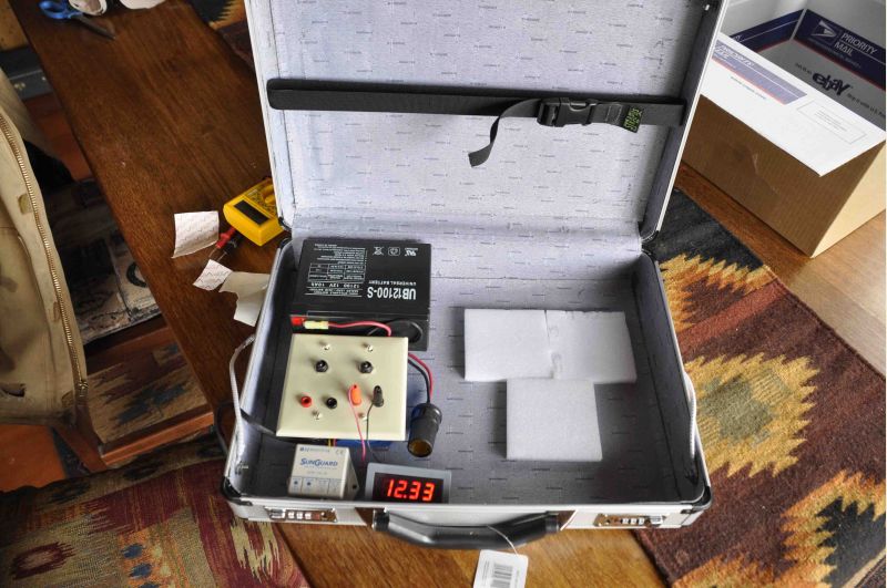

First of all looking at the site it says the battery is a SLA 12ah...this is not a standard car battery...those batteries are way smaller...believe me.
I built a very similar unit to run my laptop at the cabin and on road trips ...I use a 10 watt solar panel that can fit in the case when not needed. I recently converted from a 2.2ah to a 10 ah..just a little smaller than this units. You can read about it at my blog
http://kmswoodworks.wordpress.com/2009/12/29/solar-laptop-station-up-and-running/
Some of the modifications I made for my laptop "prototype", the banana plug port allow me to monitor voltage from the Solar panel, charging voltage from the controller, and the battery voltage. This is done my changing the meter location and switching. As an Added bonus I can plug in an additional solar panel or Battery for added power in production or storage. The space to the right in the case is normally filled with sectional foam and actually houses my laptop...an all in one configuration
I'm also building up a couple with Inverters, and twin 6 v 12ah for a total storage capacity of 24 ah...twice what this unit has. My first "for sale" unit should be ready in a few days...I just got my panels and charge controllers in the mail.
My bigger (compared to my laptop station) units I hoping to sell for about $350...
