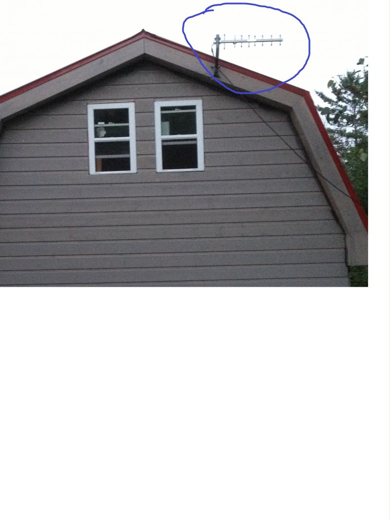

 Really hard to answer your question as every situation is so different.  I had a couple of spots around the cabin where I could get a very weak signal (not usable but enough to know that it was possible).  I did some research and found two towers in my area (one about 7 kms away and one about 17).  I did a path profile using a tool I found that worked with google earth (sorry - don't remember which one) and it actually looked like the far tower was my best bet.  The booster I use is the SOHO 60 SOHO 60.  Initially I used a wide band antenna Wide band primarily because I had one from a previous project.  With this, at ground level, I was able to boost the signal enough to make it usable.  Once I confirmed the frequency band I purchased the yagi yagi and mounted it at the roof line of the cabin.  Handy to have a metal roof as this helps to isolate the interior antenna from the exterior to avoid feedback.

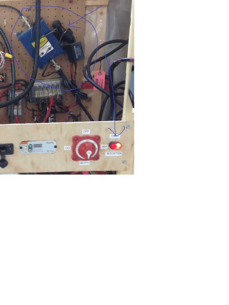

 Wilson SOHO 60.  Selected because it is 6VDC and has a car adapter so plugs right into my 12VDC system.  It is spec'd to use up to 3amps at 6 volts.  It is dual band so I can turn the unneeded band down so I see about .8 to 1 amp on the 12V side in actual use so similar to 1 and a half of my lights left on.  This is why I only turn it on when we need it and I have a big lighted button to make it obvious.  Pictures show the wiring (earlier on - lot neater now and closed in) and the yagi on the outside.
