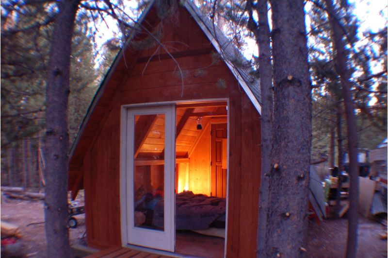

I really haven't started narrowing it down yet. One problem with sliders is the dirt/dust that gets into the tracks. I really want a slider so that I don't have to have space in the small cabin for the door to swing.
Sliding door requires less room in cabin
