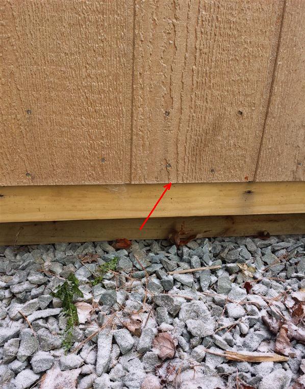

 My cabin was a prefab shed I am converting into a cabin. 12x12 with 13ft ceilings. The walls are built from 2x4s 16oc. Then there is a 1/2" wood panel material that is made of two wood types: a plywood sheet that is glued/attached to a weather treated wood sheet - that faces the outside and acts as siding.... I can't explain it any better but if it is critical I can probably find exactly what it is from the company that made me the shed.
 Then I have 2x6 floor joists that sits on five 4x4 skids... Classic shed construction.
 My cabin is about 75% insulated but no vapor barrier yet or wall finish (almost anywhere). I don't have a shower, kitchen, or bathroom installed yet.
 Yesterday, I noticed water accumulating in a corner where the 2x4 wall studs meet the bottom/sill plate and the plywood sheathing... When I touched the sheathing it felt wet.. almost soaking wet. I then touched the same spot on different walls (where the sill plate and sheathing meet) and they were all wet... Where the hell is water coming in from? I have gutters, metal roof overhang, and the walls seems to be water tights. There is no snow on the ground.
 Also, I didn't want to pull out insulation where it was installed but I was able to stick my hand beyond a place with insulation - and it felt dry... but I just checked in one spot.
 I am attaching photos of where this was but obviously it happens basically every place the sill plates and sheathing meet - I just didn't think it is necessary to have 20 photos of the same thing. I am worried this will rot my cabin and I really have no idea where this could be coming from beside condensation... I am hoping you guys will agree and tell me that once I insulate I will be home free..

 Sounds like condensation. Was it there when you arrived? Or only after the cabin had been occupied a while with prople inside? Cooking food, boiling water? What was the source of heating?
 The perimeter down low will be the coldest spot even with a fire going. Chances are good that with insulation and a vapor barrier (6 mil poly) you will not have that problem.

 Going out on a limb here...  If the plywood was very cold and a non-vented propane appliance was being used, I have a hypothesis.  Since heat rises, the bottom of the wall is much colder than the top.  Extra moisture from propane or other combustion (and human exhalation) condensed on the lower colder areas.   Could this be the case?  If so you might have noticed the extra humidity.  Insulated walls would prevent this in the future.
 Exposed metal roofs are even worse for condensation.  I've read of folks getting "rain" indoors!
 If the exterior isn't sealed enough, it may be possible for exterior water (rain) to wick through, especially up the exposed bottom of the sheeting.   Recent heavy rain?
 After that, I'm outta ideas!  Good luck.

 I didn't notice it or checked when I arrived but only after we spent the night there already... I will check it when we first get these this weekend. No cooking food, no appliances are in the cabin, and no boiling water... source of heating is the wood burning stove that has an air intake from the outside.
 SE ohio - no propane appliance or any appliance is present in my cabin.   wood burning stove provides the heat. I hope this is indeed condensation and that insulation will solve this.

 the seam between the sheeting and the framing is likely leaking cold air, causing condensation much like a leaky window.  Seal the seam between the framing and the sheeting and it will help out, as well as a proper vapor barrier as the others have mentioned.

 How about the same area on the outside of the wall?  In particular, the cut edge.  Are they wet or dry?

 PA- I didn't touch the outside but I am guessing not... Didn't look wet

 It doesn't look like there is any airflow/circualtion of air under the cabin.  Does anyone think that might be the cause?  Moisture from below?

 I recall that the ground you built on is not well drained. Muddy and wet. Could it be the wood is acting as a wick and sucking up the water?
 Building six inches off the ground could have elimated a lot of issues.
| PA_Bound Member
 | # Posted: 27 Nov 2013 04:54pm Reply
 SWLady... That's similar to what I was thinking, and why I earlier asked if the bottom edge of that exterior panel was wet (Opti indicated he didn't think so).  That first picture show a fair amount of water, and I was thinking that if it was inside humidity it would be higher on the board and running down, not low and seemingly wicking up.  But I could see how that could happen if cold air was being blown from the outside, under that panel, and up into that area.  But as warm, humid air typically rises, to be that wet, that low, I would think the iternal air would have to almost tropical.

 The ground I built on was not so muddy and there is no way it is wicking...the stones and soil around is very dry. Also it sits on 4x4 which makes it even higher.
 I was just thinking about, in order to add insulation under the cabin,to lift the cabin and slide 6x6s under the 4x4s..

 I touched the walls as soon as I walked in last weekend... they were dry. so like many have you speculated: it is condensation.
 I am almost finished with the insulation so it won't happen anymore.

 Optimistic. It was interesting that the water appeared right where you have cables coming through the wall. So a wind driven rain event.
 cough*caulking*cough.
