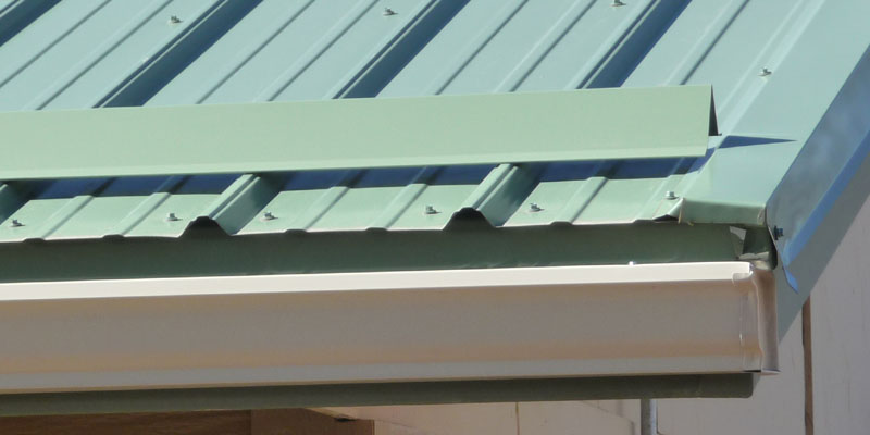

 We use the strip type of snow guards, 10 ft long strips that match the roof color. They are placed near the eve edge horizontally and screwed to the tops of the ribs with self drilling sheet metal screws. IMO better than perforating into the roof deck. They have a neoprene washer like the other screws. If not overtightened they do not leak. Will look for a photo.
 I've also used conduit (metal) along the edge about 6 inches up from the eve. Secured to rib tops with conduit/pipe straps. They are all plated for excterior use. Just do not look as pretty. One side of our cabin has that. The other with the view from the driveway has the nicer looking stuff. Home has the nice stuff.

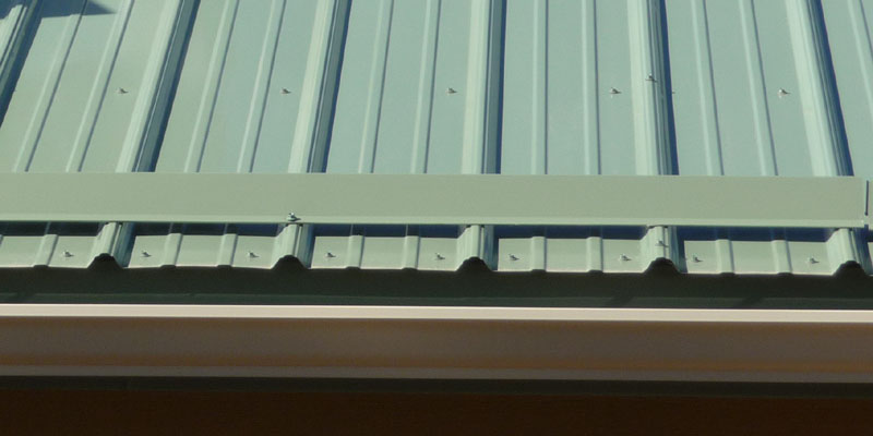

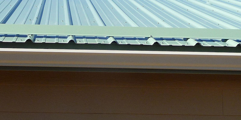

 | # Posted: 26 Nov 2013 02:16pm Reply
 It was easier to take new photos
| MtnDon Member
 | # Posted: 26 Nov 2013 02:20pm - Edited by: MtnDon Reply
 Sorry, no profile shot w/o climbing a ladder. It's sort of like an inverted V. The leg that is upslope is perpendicular to the roof whereas the downslope leg is slanted some. Screws every 3rd rib on the upslope side and every 4th rib on the downslope side.
 I got them from my roofing supplier. They roll these right there same as they also roll the other trim.
 Six inch wide gutters from another source that does seamless.

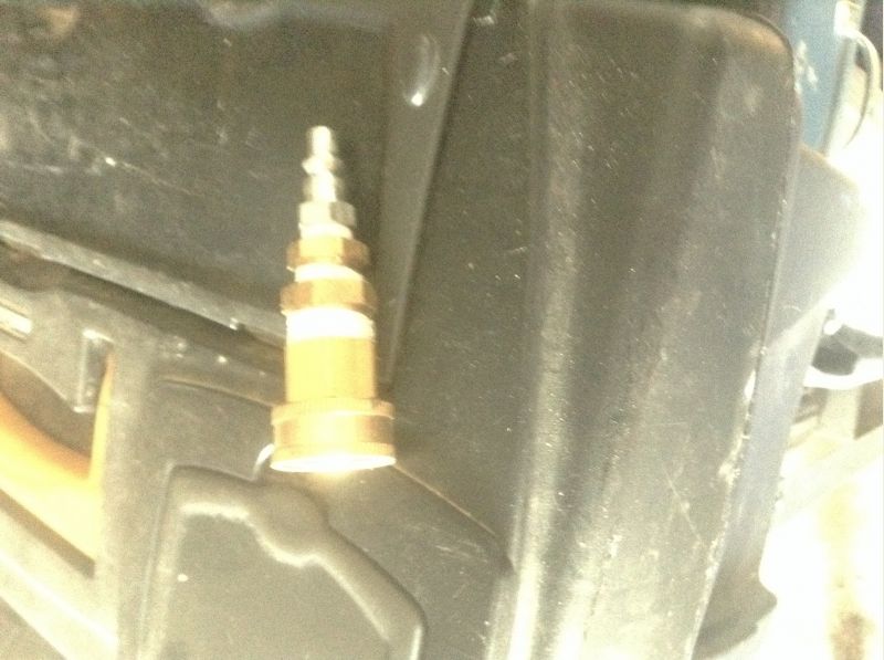

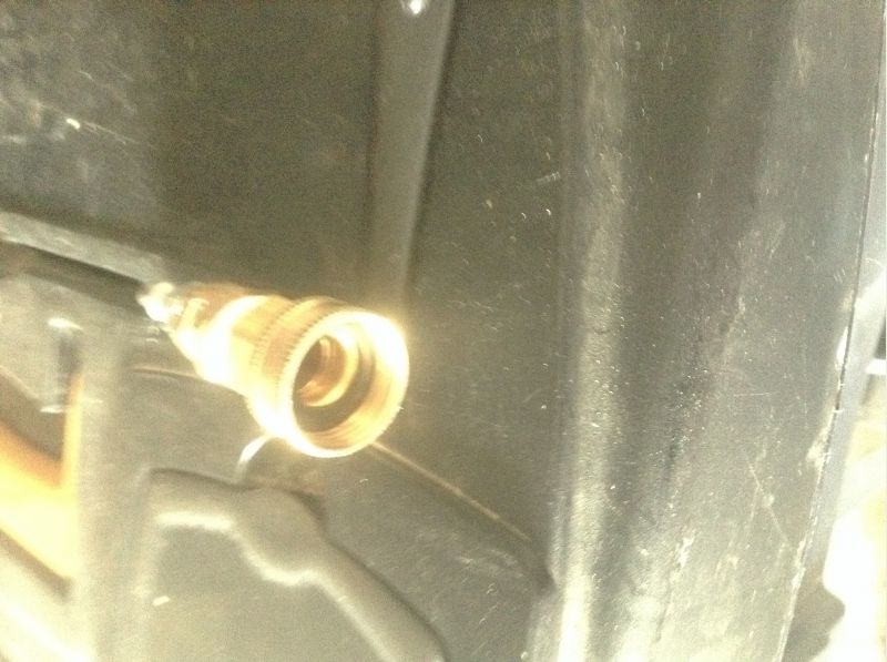

 | # Posted: 4 Dec 2013 12:10pm Reply
 If you have a tap like the one in your link you can easily make up a fitting to screw onto the tap and connects directly to your air hose. This is essentially what I have done. I have a hose connection for cold water that goes to my eccotemp water heater that is outside. I unscrew that connection in the winter and hook this fitting to that and then my compressor. I have attached a couple of pics of what I use. As far as the RV toilet goes I'm not sure if it is similar to a regular toilet but the air also empties out water that is in the tank of my toilet. I just put RV antifreeze in the bowl.

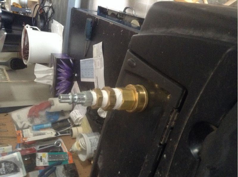

 | # Posted: 4 Dec 2013 02:23pm Reply
 This picture may show it better. Yes I connect it directly to my compressor hose with the quick connect fitting. There are four parts in total making it up. There is a female swivel hose end with a 3/4 inch adapter screwed into that. This adaptor has an inside thread with an adaptor screwed into it that takes it down to 1/2" with an inside thread taking it down to 3/8" for the quick connect fitting for the compressor hose. I charge my compressor to about 40psi and then connect the hose, open the taps and let the water flow until it's just air. With the tap you already have installed you could connect to a compressor with this fitting and then just open and close that tap to control the air flow if you wished. I have one of these made up I leave at the cabin with a small compressor. I have one made up for home with my other compressor I use to blow out my hoses and water lines for landscaping. Works great and is quick and easy. All parts were purchased at Canadian Tire but they are readily available at Home Depot etc.
 |  Hose connector better pic
