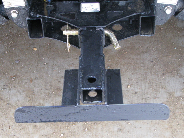

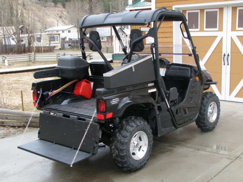

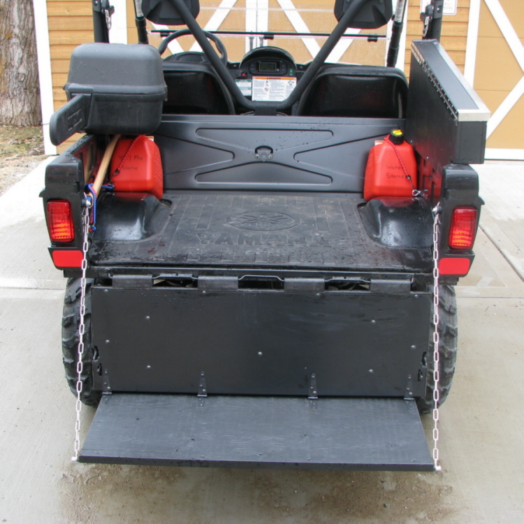

 Bob took the chain off the tailgate and he put a stop that plugs into the trailer hitch mount so the tailgate stops, hanging down, almost vertical when you open it.  Then he hinged a piece of plywood to the top of the tailgate that opens to form a step.  He put longer chains on to hold that up horizontally.  This makes a great step if you have a dog that wants to ride in the back.
 The truck box floor gets really hot. If you have a dog in there it can be a problem so Bob put a plywood floor (removable for if you are going to put sand or something like that in the back that might plug up the gaps) in the truck box on spacers.  This forms an air gap to prevent the floor from getting so hot because it is right over where the muffler is.  He also put plywood on the front of the box as that got hot too.  Works perfectly!!!

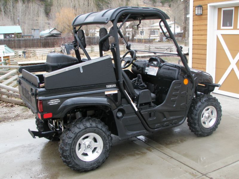

 Here are some pictures of the back step that Bob made for the dog.  Our rhino was nice and new then.
