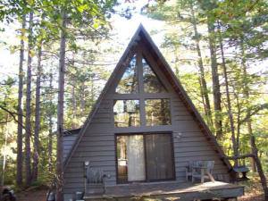

 I've recently purchased an A Frame in Paradise Michigan.  This area averages ~200 inches of snow per year and we've already received around 170 inches.
 This is my first A Frame and I'm so excited to not have to worry about clearing the snow off like my roofs on my 'off the grid' cabins nearby.
 I am curious however, how may people clear the snow buildup on the ground once it slides off?  There is currently about 6 foot of snow built up from the ground up the bottom of the roofline.Im concerned that theres to much snowload at the base for the roof/block foundation or what other issues the large banks of snow could cause?

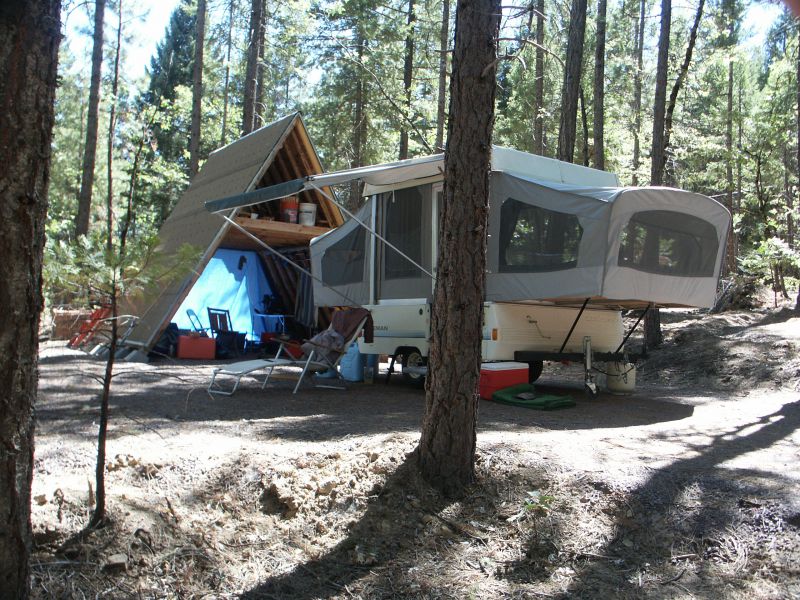

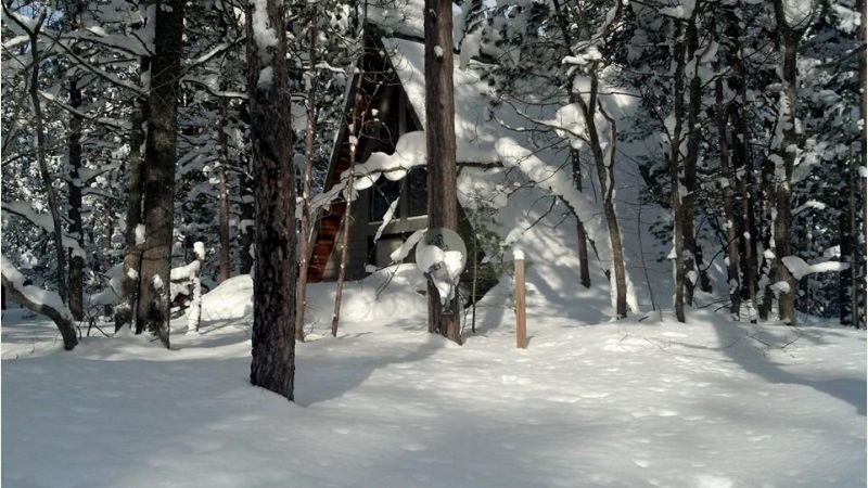

 I have an A frame in California at 4000 feet, which is not a very good comparison to the kind of snow you are getting. But I have gotten 4 foot snows on it and I've never seen any evidence of damage.
 I've heard of snow piled up against sliding glass doors gradually pushing in and breaking the glass. I've also heard of large snow falls on hillsides gradually moving downhill, like a glacier. But you are on a flat so that's not going to happen.
 I think you're just fine. A frames are so strong I think you'd need 15 feet of snow against it before you'd even need to think of structural damage.
 As you can see my A frame is just set on piers on grade. Even with large piles of snow on it, the piers, or connection of wood to piers, hasn't budged
