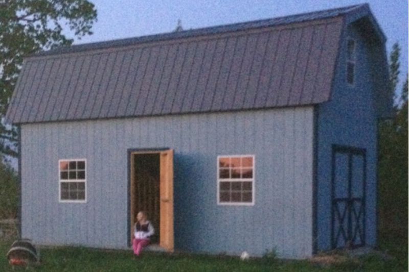

Well, I have been making some early progress. I found this 1.5 year old 12x24 Woodtex shed for sale on craigslist. The lady I bought the shed from was in a bad way financially. I bought it for less than half the cost of a new one, including the fee to transport it 55 miles away to my land.
This week I started bulldozing the new roadway and build site to move the shed onto. Bulldozer cleared the road on Monday then sadly Tuesday and Wednesday were horribly wet in NYS, multiple inches of rain! I have 15 gravel trucks lined up for Tuesday next week to lay #4 gravel over my geotextile fabric on the new 850' driveway. Supposed to be dry until then, hopefully the road firms up.
