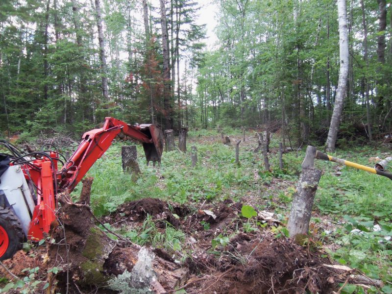

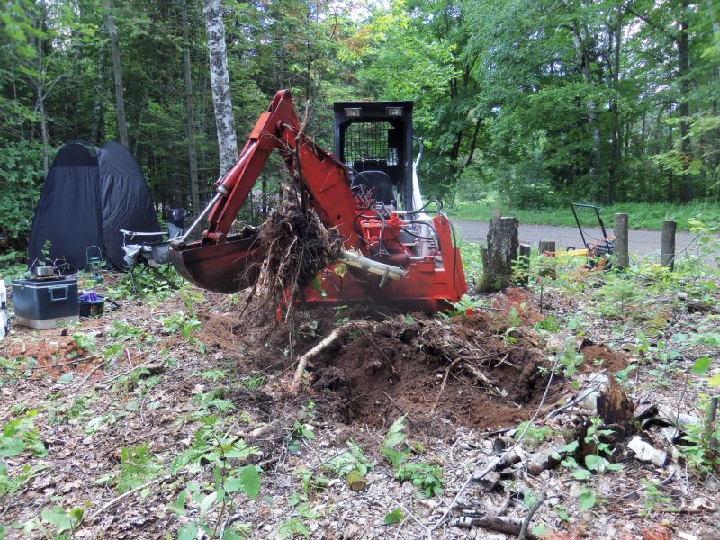

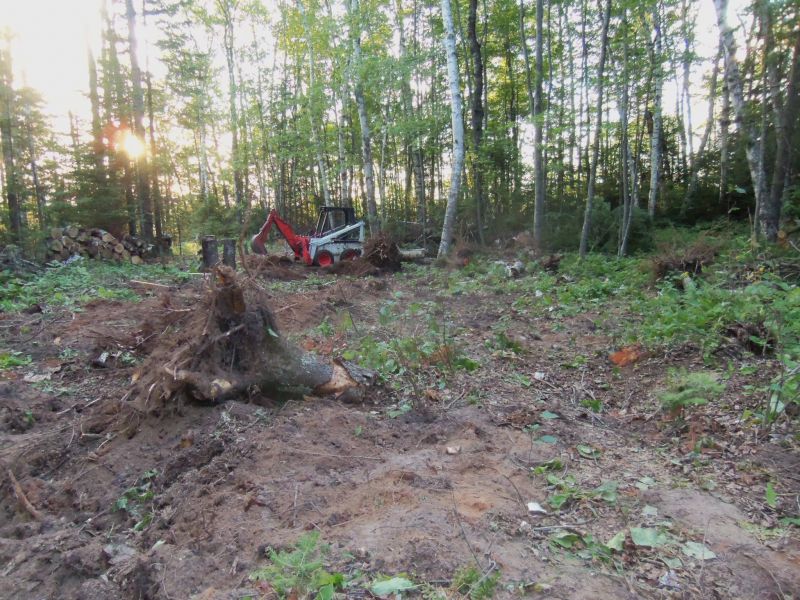

Used the bobcat in the picture,some chains,cables,VERY big come-a-longs,axes,shovels the little machine is not very heavy so there is still alot of labor involved if the stumps are big you will want to rent the biggest excavator they have and after you get them out some are so heavy they just tip my bobcat. I have spent 8 hours to remove one stump some can be difficult, Bib bobcat with forks also work but I have also used pick-up trucks dig around the stump and just start jerking on it with the truck It'll come out. 100_0395.JPG
