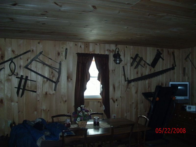

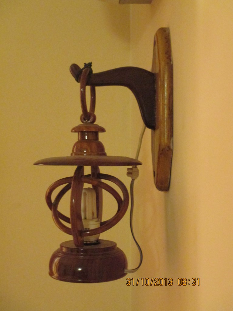

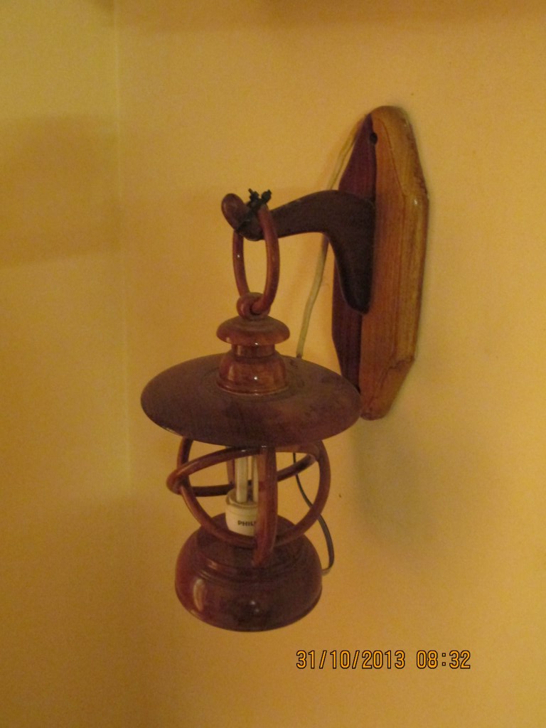

ILFE
# Posted: 31 Mar 2014 09:49am
Prior to moving to the city we live in now, we stayed in a hotel here. (We had come to start installing the solar and rainwater harvesting for our farm house.) Anyway, one of the first things I noticed, were the wall lighting fixtures, apparently built by a local craftsman, throughout the hotel. I took images, because I wanted to add them to our place at a later date. They can be wired for any voltage and any fixture one may wish to run.

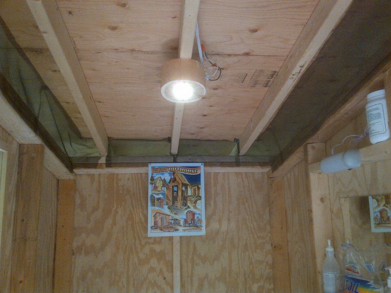

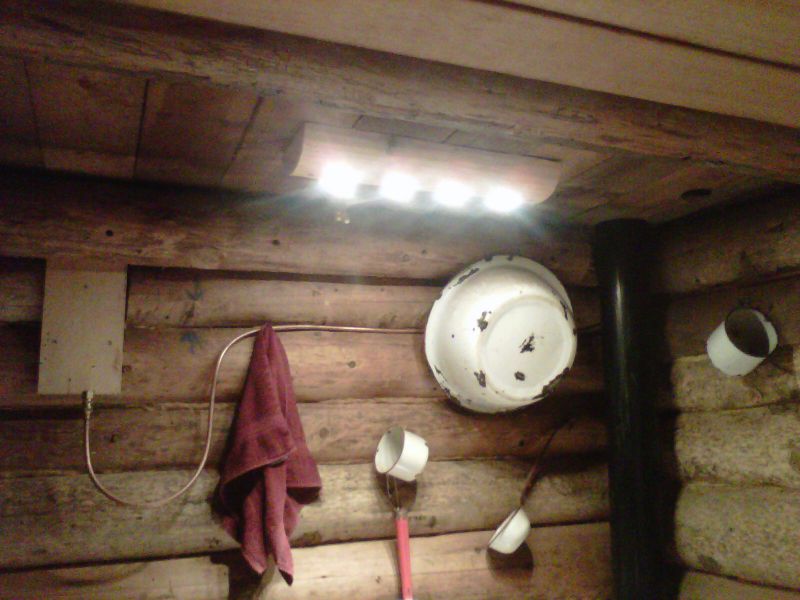

# Posted: 31 Mar 2014 11:15am
At my place I have propane lighting in my off grid log cabin. I wanted to supplement the propane with other lighting but I wanted to keep it rustic. There is another thread on this forum about lighting and I took ideas from that and made lights using 12v LED lights. The bulbs are small, can be used as recessed lighting or incorporated into low profile ceiling lights etc. The LED bulbs are also available in 120v. The receptacle base is readily available for about $3-4 and can be incorporated into anything. They are very bright and use little energy and do not get hot. Here are some pictures of what I did. I am actually thinking of installing a few of these bulbs above my couch right into the log joist that supports the loft.
Bathroom light
Bathroom light
loft light
loft light
loft light installed
outhouse light.
outhouse light.
