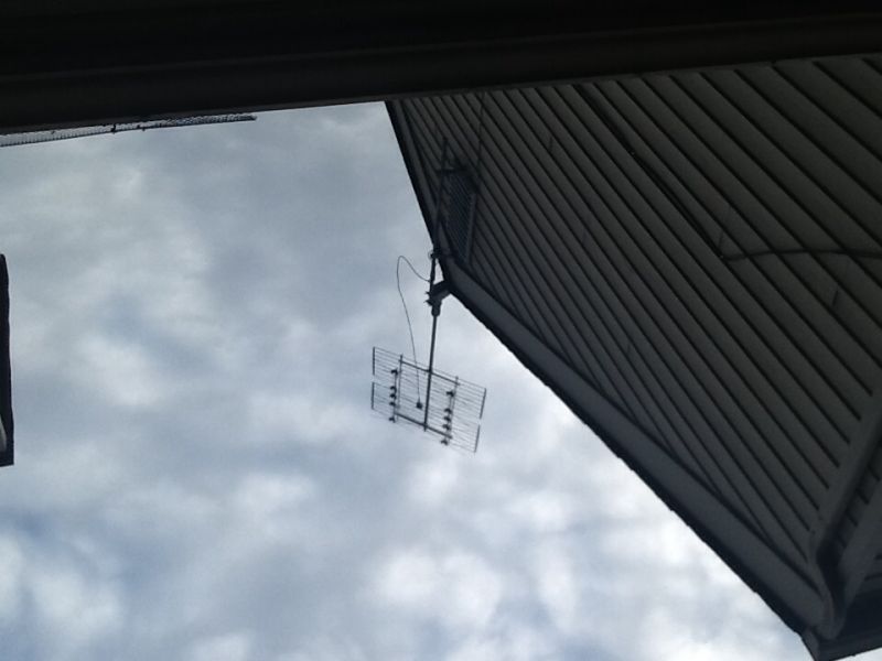

| toyota_mdt_tech Member
 | # Posted: 24 Apr 2014 02:05am Reply
 Quoting: yankeesouth Okay.....I know this is a taboo subject for many folks.......But....... does anyone who has a cabin in a mountainous region have any success gaining TV reception?
 YES! Perfect clear digital picture. I installed a flat screen wall mounted TV high up on a swivel. I have the directional antenna inside my attic to keep the exterior appearance looking rustic and pointed it to the mountain where the digital free TV signals are transmitted from. Its so nice to catch up on news and watch some shows. Limited selections/channels, but enough to get the job done.

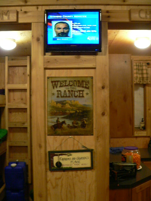

 | # Posted: 24 Apr 2014 10:41pm Reply
 Found a picture of my TV on using the small Yagi 7 element directional antenna.
 (note, picture show was an APB, looking for the clown who was drunk, got into an argument with his dad and shot/killed him with a hunting rifle)

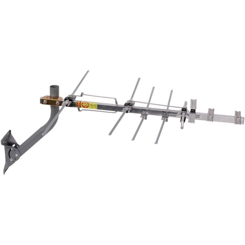

 | # Posted: 25 Apr 2014 07:59pm Reply
 Bob, the antenna I got was an 8 element, made by RCA, $50, here is the exact unit at amazon. Its not UHF, just the regular I guess VHF.
