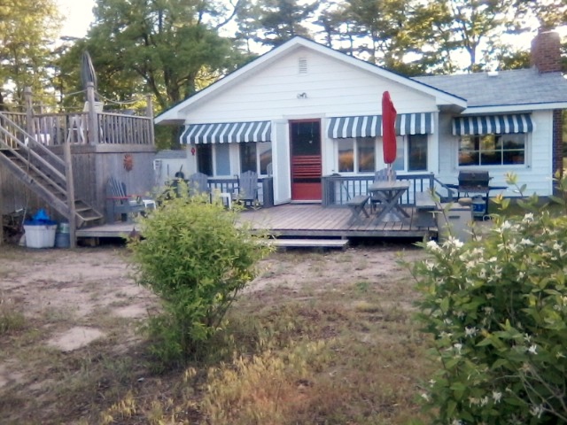

# Posted: 5 Aug 2014 11:48
In the pic the lower deck 12\24 under 24 in --- no permit ,, upper deck, built a year later [a different ASK] 96 sq. ft. no permit BUT" advice of " a 48 in. solid railing !!
at the lake
at the lake
