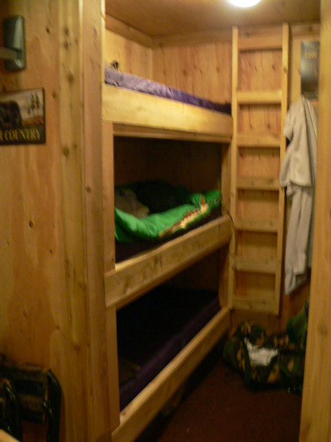

 How about bunks with a ladder. Kids wil be fighting to sleep on the top bunk. I did it, but for adults too, they are 6'4" long, little less that twin bed in width. First one is 12" of the ground, then each has exactly 28" of space. (full 8 foot walls)
