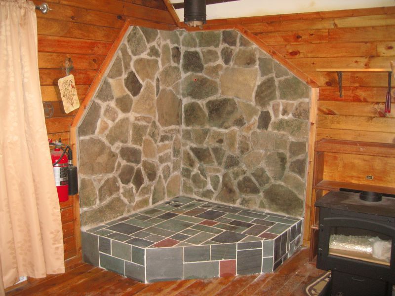

OK, thanks for all the help. You have been great TSC had the 100 lb. tank on sale and I bought it and got it filled. Got a cheapie pneumatic wheel two wheel dolly to move it. Gather up all my 1/2 black iron spares, some pipe and my tools. Truck is all packed for this weekend and between hunting I was going to install this weekend.
Got the unit in last night and reading through the documentation I found that I need a 36" clearance above the unit, 6" on the sides and 4" on the bottom from combustibles. The walls of my cabin are pine shiplap. Well it really doesn't state what a noncombustible is but I'm pretty sure pine board is.
I had intended to install this next to last year's project being my stone wall hearth that houses my wood stove. this is the focal point of my cabin and it is beautiful. I'm too far invested into the propane heater project to turn back but I don't want a cobb job either. Attached is a picture when I completed the hearth. Behind the woodstove where the barrister exist is where I had planned to put the direct vent heater. It really doesn't fit anywhere else due to windows, doors, utilities and furniture.
I mull in my head what to do. Cement board with tile on top of wall? Most likely would look like crap. Build a wall in front of the shiplap wall out of layers of fire retardant drywall. Not that aesthetic again but maybe I could make it work. I just don't see it though.
Any suggestions. I'm beside myself. HELP!!!
# Posted: 8 Nov 2014 09:59am
I have a different propane unit, but the wall behind doesn't get that warm. The docs seem to be saying nothing combustible beside, below or above. Not behind. I think they're just trying to tell you not to put furniture to close, block the air intake at the bottom, nor overheat stuff above (tho I dry my cutlery above mine. and occasionally warm mittens).
you could cut out the shiplap where the heater goes and fit in cement board or drywall. Then tile with the same stuff as the base of your woodstove platform. Tie it in visually. Bit of trim. It would look great.
Of course I'm no designer. But from a workers perspective. It would be pretty easy to circular saw out the area and then fit drywall. Eh. Put some paint on it. Done.
Heck. You could probably prefinish the drywall and have it all ready to go before you head to camp. lol.
