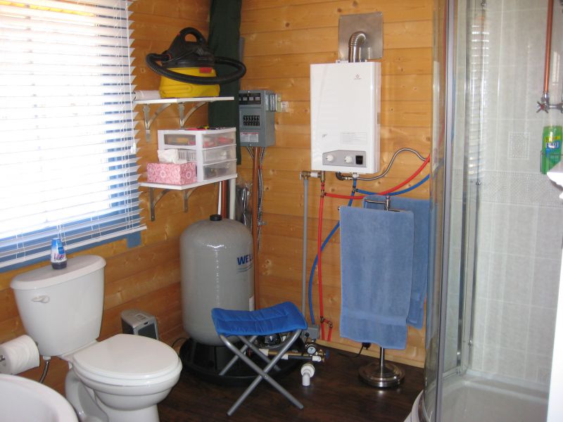

| drb777 Member
 | # Posted: 5 Nov 2014 01:19pm Reply
 OK, I would agree that the L5 is very marginal when the water temp approaches 32 degrees. I think you'll find that any attempt to pre-heat will be quite difficult. But I could see one using a small re-circulating pump to preheat a batch back to say a 5 or 10 gal accumulation tank. 'Just not too sure it would be any better than simply switching to a higher BTU unit, as bldginsp recommended. When I finished-out my recent cabin-build, I installed a FV112 NG 74,000 btu that has plenty of capacity(see photo). Actually, eccotemp now offers pre-heaters;
 http://www.eccotemp.com/eccotemp-ep-2-4-electric-tankless-water-heater-booster/
 but the high electric draw would make them impractical for many applications. If you try to heat-up a large tank, I think you'll find it takes way too much BTU capacity than is practical. Good luck.
