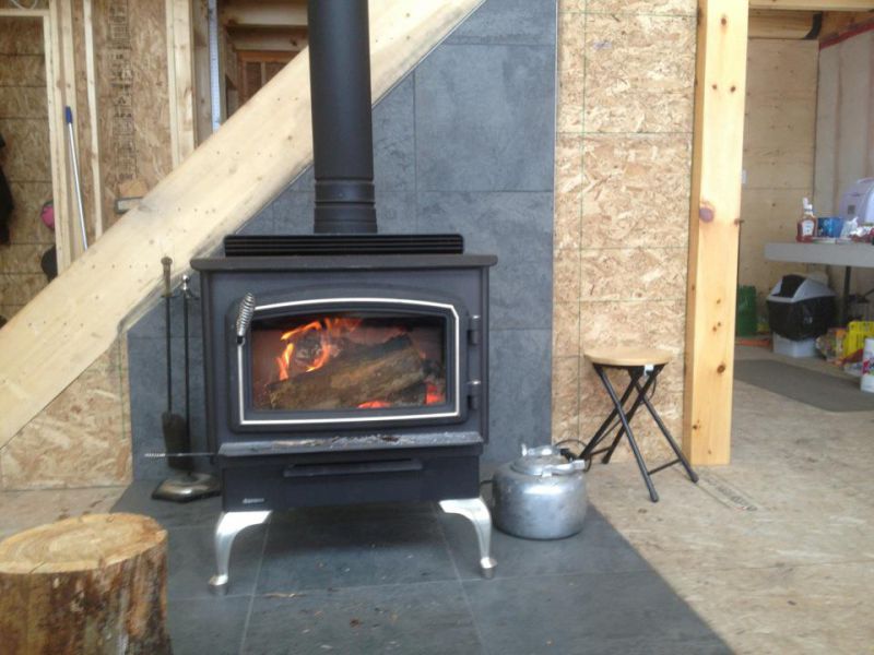

 We have a 1700sq cabin with loft and we have one stove to heat the whole place we go there all winter even -35C -31f. Your cabin should go up 5 degrees an hour with a good fire going. 5-6 hours to heat when we are at our coldest. If its not doing that maybe stove to small or old, time for a new stove.
 this is the stove we have
 http://www.regency-fire.com/Products/Wood/Wood-Stoves/F3100.aspx
