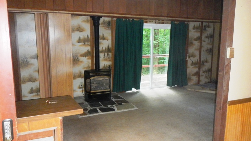

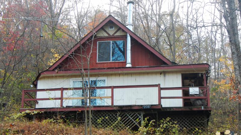

In the cabin I purchased at the beginning of the year there is a propane gas heater (Harman Clarity 929BV). So far I have had no luck getting it to work, and personally I would prefer a wood stove anyway. I know that normally the stovepipe is different and can't be used between the two types of stoves. However there are a couple of odd things about the current set-up. Look at the pictures and see if you can help out.  . First the interior picture with the heater. It sits on a cement and slate pad that looks to have been a DIY build. Why do that for a gas heater? The exterior shot shows the stovepipe which appears to be stainless and I have been told by a local that it looks just like the one he has for a wood burning stove. The place was built in the early 80's but the stove was bought in 1996. My thinking is that originally there was a wood burner installed and it was replaced by the gas heater. I have seen multiple places online that say you can't use a gas stovepipe for a wood burning stove, but what about the other way around? To cut the install cost of the gas heater could you just use the wood burning stovepipe instead of replacing it all? The interior stovepipe is black not stainless but is that something that would be done with a wood stove pipe just for the look inside? Or would they have used the gas heater pipe from the heater to the ceiling and then just mated it to the old original wood stove pipe from there? Just wondering if anyone who has more experience has any insights into this. It would be nice to just be able to reuse the pipe that is there and not have to replace it all! Also anyone know any east ways to tell the difference between the gas stovepipe and wood stovepipe? Thanks for any help guys! Mica_Inside_Stove.jp.jpg

i agree it looks like they started with a wood stove . if a magnet will stick to the black pipe it is steel and can be used for wood heat as long as it is not painted galvanized pipe . IMO

You don't say what the problem is. It could be related to the chimney or it could be something else altogether.
Have you read the user manual? It is available with a Google search. That stove/heater is supposed to use a 4" B vent. It is possible that if used with a larger size chimney pipe, like a 6 or 8 inch wood stove chimney pipe, the exhaust may not have sufficient velocity to operate properly. That can happen with improper size pipes on a wood burner, perhaps the same can be said for gas fueled heaters. Just a guess.

If the appearance is better with the large diameter black stove pipe a B vent liner could be run up inside the existing pipe all the way to the top.

Quoting: horaceunit It sits on a cement and slate pad that looks to have been a DIY build. Why do that for a gas heater?
Appearance? Or a left over from the old wood stove. They probably got tired of cutting wood, hauling ashes, etc.

Sorry, wasn't too clear on the gas stove problem. Supposed to have a blower. It doesn't work at all. Used a three prong extension to a couple of know good outlets and it still doesn't work. The little push button starter (like on a propane grill) doesn't work. Even using a match I couldn't get it to lite. What I did (no pics of this, unfortunately) was to adapt an outside 50 gallon tank hook up to a standard grill type propane tank with a regulator. That tank has propane, and it worked fine on my grill. I never got a whiff of propane, but the stove directions say you shouldn't. I know the property has sat empty for at least 5 years so who knows. The other thing I didn't do was get a measurement of the inside pipe diameter. Well guess I have an excuse to make the 5 hour trip again next weekend! Thanks for the insights!

Sometimes a spider web or bugs in a gas inlet can wreak havoc. The chimney pipe looks like wood stove pipe but this is only a guess from your pictures. If you can smell wood residue or creosote at the top of the chimney then it would be a good indication of wood burned at some previous time. As for the propane - sounds like the gas is not getting to the stove. Sometimes if the unit has sat for some time, then it could take a minute of two for the gas to get to the stove. I would get a pro to look at the pipe and check the connections.
# Posted: 23 Nov 2014 05:41pm
That stove pipe looks like it started life out as a woodstove chimney. Both diameter, appearance etc.
As Mt Don said, maybe its oversize for the gas stove? Could a smaller sized pipe fit inside of the woodstove pipe if that is the case? Just bouncing ideas around.

That propane stove takes 4" pipe, so definitely was a woodstove in there as the two pics clearly show at least 6" woodstove stovepipe.
