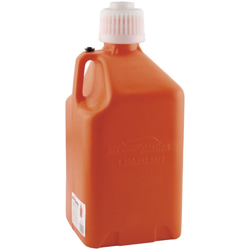

# Posted: 3 Dec 2014 09:30pm - Edited by: toyota_mdt_tech
OK, you said metal, but we had a junior motocross team and I used Scribner Jugs from Scribner plastics. In fact, I have 4 of them, 2 clear for premium, one orange for 2 stroke mixed (we raced orange KTM motorcycles) and I even picked up a green one for diesel. I wanted to get a yellow, but they discontinued that color. I use these to make my pure gas runs (alcohol free gas).
I installed the pour spout. There is a 3/4" pipe plug in the cap, remove it, install a small brass nipple (shortest you can buy), then screw in a nice brass gate valve, then the poly pipe threaded to barbed fitting for the clear flex hose, the flexible plastic hose you find in plumbing for a pour spout, get it all at Home Depot. Then at the end of the pour spout, get a barbed push in poly pipe fitting, same as the valve end, then add the PVC plastic cap that screws on the end now to keep water and dirt out of there.
I can fill my Honda gennie with ease. I just tip the entire jug upside down, nozzle in the gennie tank, crack the ball valve open a little, shut off when its full. No spill etc.
Now the website reads "not for gas", its just a legal deal because they dont have the nanny caps required now. Works great for gas, diesel etc.
They have a website, but it seems to be down. http://www.scribnerplastics.com/
But you can buy them from all sorts of off road motorcycle shops. http://www.motorcycle-superstore.com/1483/i/scribner-plastics-spacesaver-utility-jugs
The jug is about $35, but when you get the spout set up, its a little more. But it will be the last gas can you will ever buy. If you get more than one, you can swap around the nozzle cap vs setting all up with a nozzle.
Also, great holders to contain these inside a trailer, but I use a motorcycle tie down with great luck. They are squarish and therefor, stack close and tight. The rounded ones dont and bobble around more.

t_m_t, I have plastic too for usual uses but for long term storage I kept reading metal was better for storage. The plastic ones I have are older and I always smell gas when transporting...when I filled the metal cans up I didn't smell gas. I really wanted Jerry style cans as they stack and like your square cans pack better then a round can but were $50 and many mage in China. I don't plan on pouring out of the JustRites but siphon the fuel out at some point.
I've seen your jugs before maybe you've posted about them before...I remember looking at them in the past.
I like your nozzle setup and the shape of the can. I can use a couple of them to replace my plastics.
