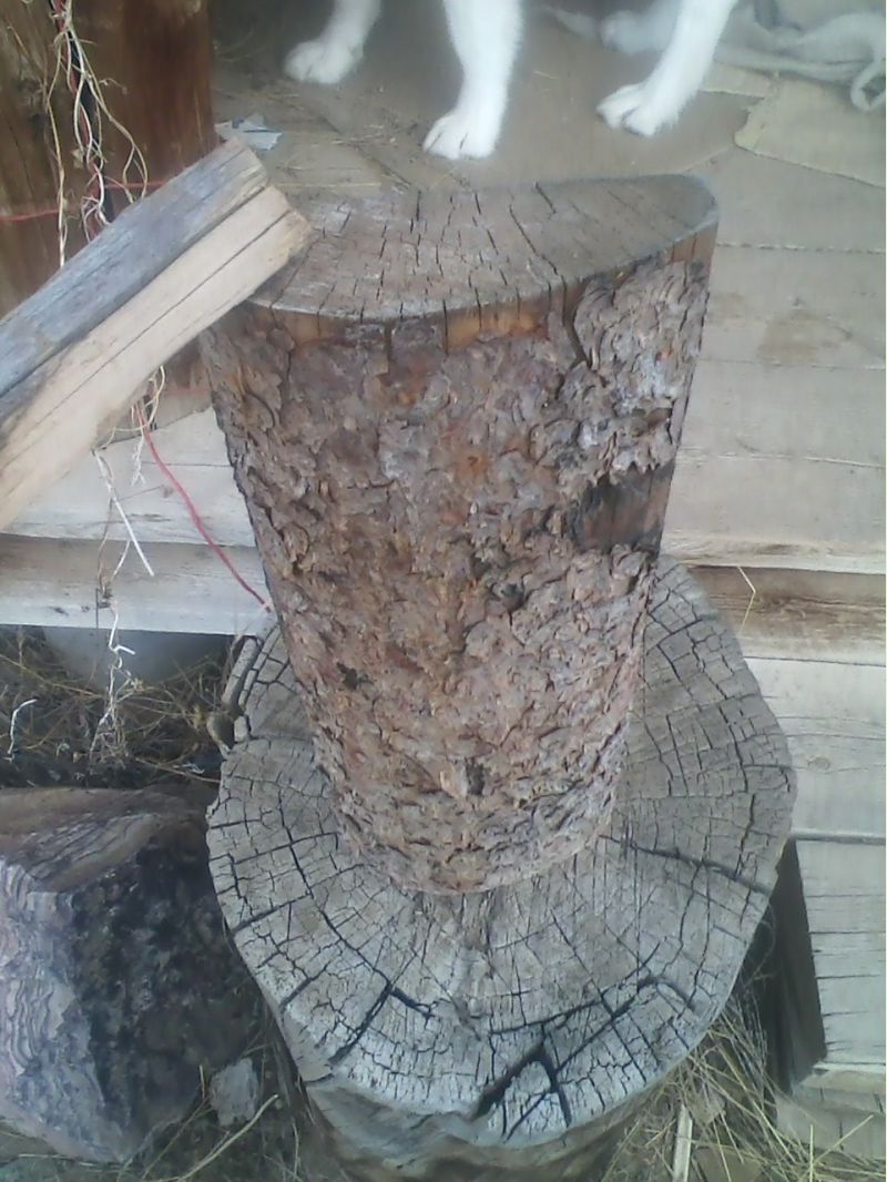

I'm not understanding what the nail does or how it bent from the wood tilting.
I've used just a piece of split kindling or small piece of firewood. All it needs to do is keep the wood from moving until you hit it with the hatchet/axe.

Your sissy stick makes perfect sense, Malamute. I got the nail in the stick idea from Youtube. It doesn't work.

# Posted: 18 Jan 2015 06:58pm
Quoting: rmak Your sissy stick makes perfect sense, Malamute. I got the nail in the stick idea from Youtube. It doesn't work
It made me nervous chopping kindling in the past, it just seemed easy to pick up a piece to hold the wood while chopping each piece. Cheap (like me) and easy.
It helped me figure out a way to hold a ground rod while somebody wails on it with a sledge hammer also. I didnt like being the rod holder guy. I took a 2' piece of 2x6, drilled a 1" or so hole in it, and give it a little twist to tension it. Then the rod doesnt bounce/wave all over while being driven.
