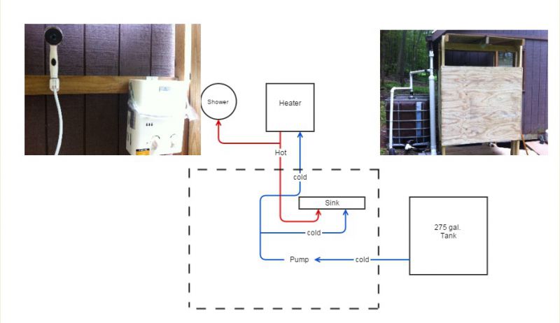

 I'm looking to upgrade our water system.  Currently i have our flojet water pump. housed in a cooler that setup for a "grab and go" setup with quick connect fittings..  I keep it in the shed along with our L5 water heater.  This creates a few problems 1) It seems if I don't go to camp and set it up it doesn't get used. 2) The quick connects don't provide an air tight seal and leak a little water thus the flojet constantly runs to keep a prime.  I'm looking to move the pump indoors under our sink and permanently mount it.  Looking to get a little input in design.  here is a basic diagram I made up wondering everyone's thoughts.  Also distance between tank to pump is less than 5' and pump to heater/shower/sink is under 5' as well.  I was looking to plumb everything with stainless braided line for simplicity, does anyone see a problem with that ?  Thanks for the help.

 Only thing I can think of off hand is a drain valve on both sides so you can completely drain the system out.

 Just for the record there are industrial quick connects that do not leak at all.  US Plastics has some.
 If you are going to use the S/S braid covered flexible hoses I would try to fit them to brass threaded fittings rather than plastic threaded nipples. I have seen a few of the plastic fitting ends as used on RV water pumps easily cross threaded when being removed and replaced a lot. I installed a couple of brass adapters to each end of our Shurflo's.

 Stainless braid will get pretty pricey. I used stainless in/out of the pump for 18" for flexibility and noise dampening. And then I put brass adapters to pex. pex is super cheap. you could use shark bite fittings. but i got a pex pinch ring tool on sale and just use the rings. again. ultra cheap.
 i've done over 30 fittings now and not one leaked. and once you figure out how easy it is. well. now I have two water systems. an outdoor tap...

 Thanks for the opinions guys.  On the pricing issue, maybe i'm thinking about this wrong.  but 5' of 1/2" PEX with push to connect ends is going to run me roughly $15.00.  I can by a 5' section of braided stainless for $10.00 plus alot more flexible for the few short runs (5' or less) I need to make.  I've used PEX and P.T.C fittings in the house and it does work flawless but found it a little rigid for the shorter runs that I thought the S.S braid might be more flexible for snaking from outside to inside the cabin.  Again, I'm no plumber and might be thinking about this all wrong.
