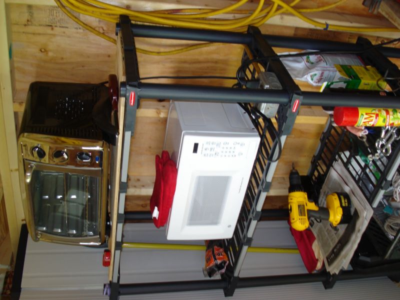

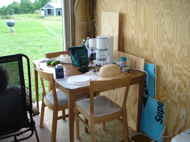

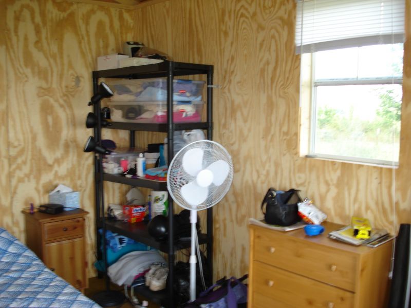

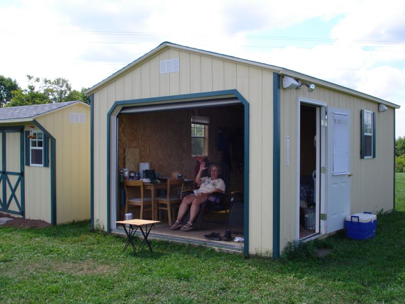

Here's a few pictures. Look, the wife's waving, lol
"GARAGE"
"GARAGE"
INSIDE #1
INSIDE #1
dining room
dining room
kitchen
kitchen

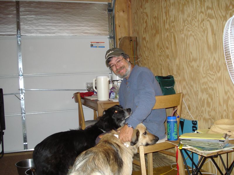

Xplorer
# Posted: 23 Sep 2010 02:26pm
Here is a poor picture of me, the dogs, & the inside of the overheat door. Here only the upper panels have the insulation installed.
