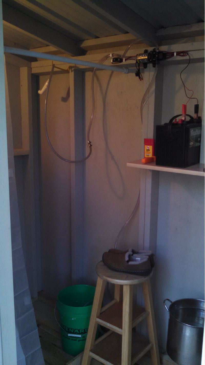

I heat water on the turkey fryer for my showers. A couple of gallons of water will be plenty hot in 10 minutes or so. From there a hose goes into my pot and is pumped with a small transfer pump to a kitchen sink spray nozzle for my shower head. Simple but works well. The turkey fryer works great....just be safe
Apologize for not the best picture...only one I could find at the moment.
Shower House 1
Shower House 1
