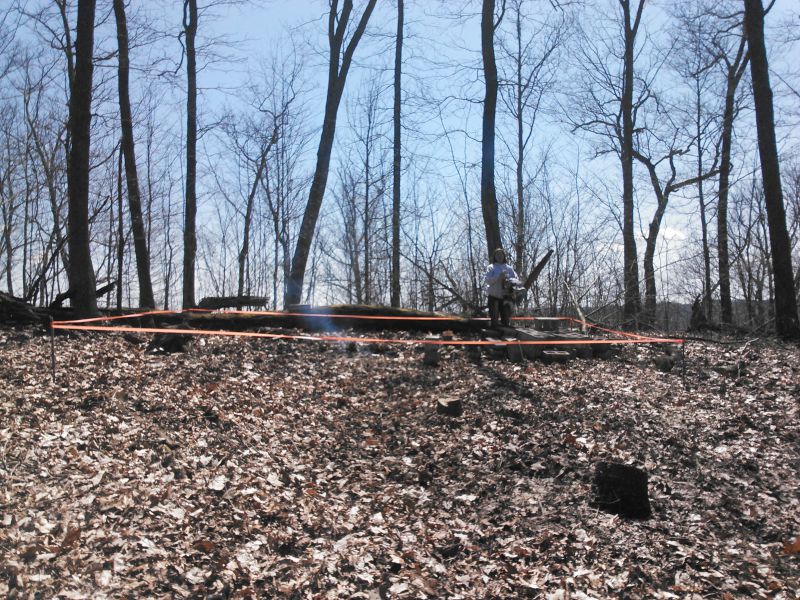

# Posted: 7 Apr 2015 06:07am
No advantek close by. I'll have to do my best. I think I'll be able to keep it dry. I'm close enough to check on it daily. I'll have a four day weekend in May and June to work on it. Going to try to have it dried in by mid July. Then I can take my time to finish. I'm going to start my trailer mods this weekend to be able to haul my lumber. That's my wife in the pic. we had a great day with the kids working and clearing brush!
