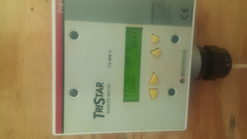

My solar panels((3)230w) are now in place and all components are connected. I bought a decent 8x16' enclosed trailer have all components stored inside, panels are roof attached. I love the setup. It's been a week now since everything has been hooked up and completed. I'm happy to report that the controller is working flawlessly. No faults, and at almost peak sun was pulling in 29.xx amps(370w)solar input! So sweet to watch the wheels spin Heading up again tomorrow for 4 days. Hope to find out what max sun can produce..

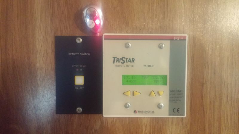

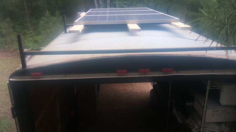

pizzadude
# Posted: 10 Jun 2015 09:54pm
Reply Quote
Cheap batteries. But they've served me well. Haven't fully discharged yet. But I play it conservatively.. 20150607_131925.jpg

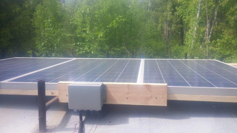

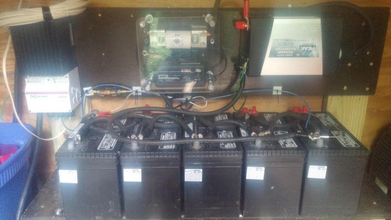

pizzadude
# Posted: 15 Jun 2015 07:42am
Reply Quote
