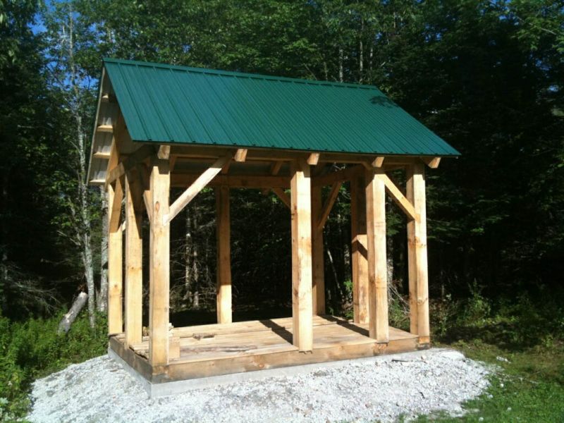

here is what my "wee cabin" looks like so far

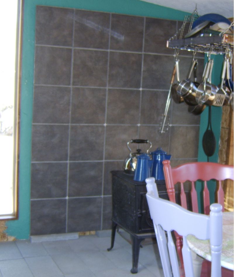

I used 12 in floor tile set on a 4x6 tile backer board (or whatever you call it)
Cedar Trip
# Posted: 19 Aug 2010 08:07pm
Ops i hit post to soon... Anyways I put that on the wall with large screws and 1 inch spacers and large washers so it set away from the wall an inch and up from the floor a couple of inches with 3 small sections of stepping stone underneath to give it air flow around the back. It works great. Cedar
Cedar Trip
# Posted: 19 Aug 2010 08:14pm
here is a picture. after looking at the pictures I actully used 2 3x5 stacked on one another. I do have a much larger stove installed than the one in the picture.
Cedar

Since our floor to our kitchen bulding is mostly brick pavers the stove just sits on blocks with block caps . It doesnt get hot under the stove anyways. Remember this isnt the stove in the picture thats shown above. We have a larger one setup and its still fine.

I used the same method as Cedar Trip did behind my stove and works fine. I bought a hearth pad for under my stove because I like the look.
