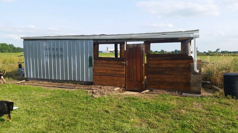

Grandma Off Grid
# Posted: 20 Jul 2015 01:45am - Edited by: Grandma Off Grid
i am building a small cabin with attached greenhouse. i already had the basic structure on my land. steel roof and 2 walls. heavy beams. and i have saved up a bunch of building materials so only 20$ out of pocket right now and i am halfway done. i dont have much building experience and am a 51 y/o girl. but when i get stumped, i sit in my chair in front of it. meditate. and the answers come. so far so good.
Grandma Off Grid
# Posted: 20 Jul 2015 01:51am
it looks much better than that now. boards trimmed, etc. some painting done. gutters repaired and painted. more done but have to take more pics.
