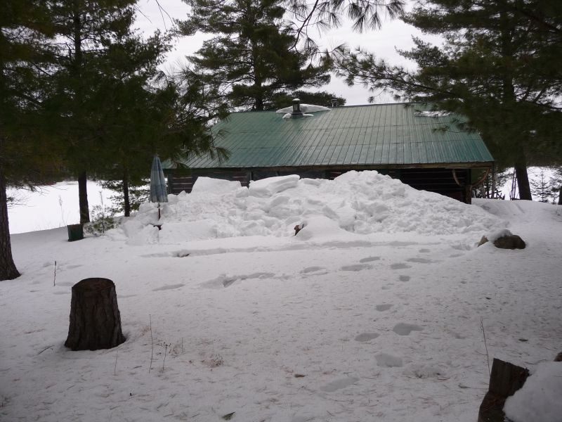

 Last winter we showed up at the new place for the first time in the winter months.  As you can see from the picture unless I was willing to do a lot of shovelling I couldn't get in the back door.  So we went in the front.
 Last weekend I installed a new Patio door in the front that does not have key opening access from the outside.  I might look at replacing the lock so I have that option, but I'm trying to figure a way to divert the snow away from the back door when it slides.
 Any suggestions as to how I can do that?

 Google "snowbirds, roof"  or  "snowguards"

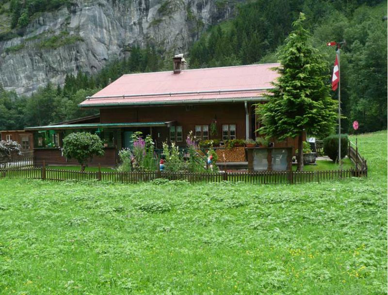

 Pipe along the eve edge also works... been used in Europe for decades.  I did that on our cabin roof.  Of course. the roof must have been designed and built to manage the expected snowloads.
| NorthRick Member
 | # Posted: 31 Jul 2015 12:16pm Reply
 That's why I put doors on the gable end of a building.  People have been killed by snow and ice sliding off of roofs.  You can install snow fences on the roof which will prevent it from sliding off.
 Another option would be to put a small roof over the entrance with the peak running perpendicular to the peak on the cabin.  As the snow slides off the cabin, the entrance roof would send it to either side.

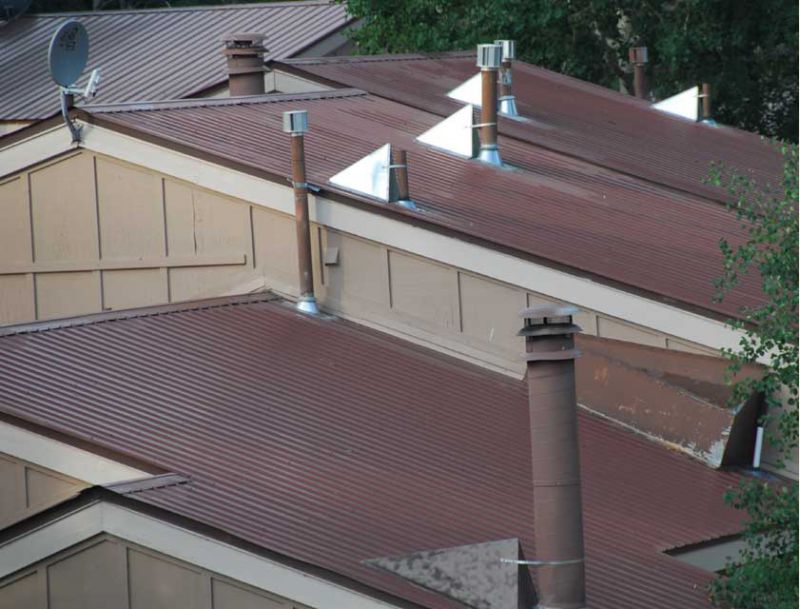

 Some places also need show diverters to prevent snow slides from removing chimneys, vent pipes, etc.
 This is in Colorado.
