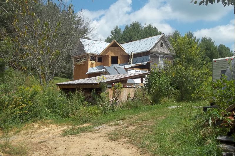

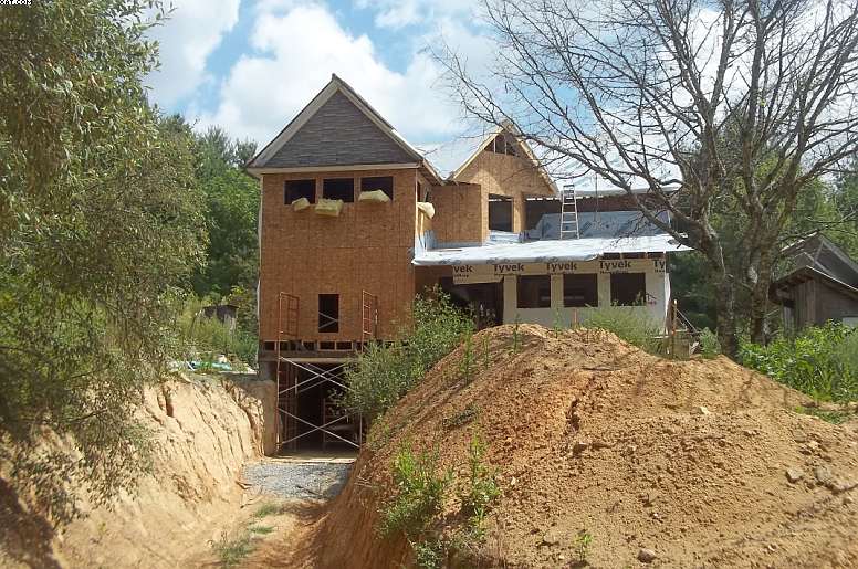

Attached are a few pics of the job I've been working on. In the firste shot You're looking at the backside up the trench we dug to allow us to get a bobcat under and dig out a full basement. This is the third foundation under it. Third roof from what I can tell for that matter.
Next shot shows the angled dormer at the top of the stairs inside. It created a nice area there and harkens back to some of the older victorians scattered around here.

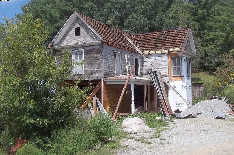

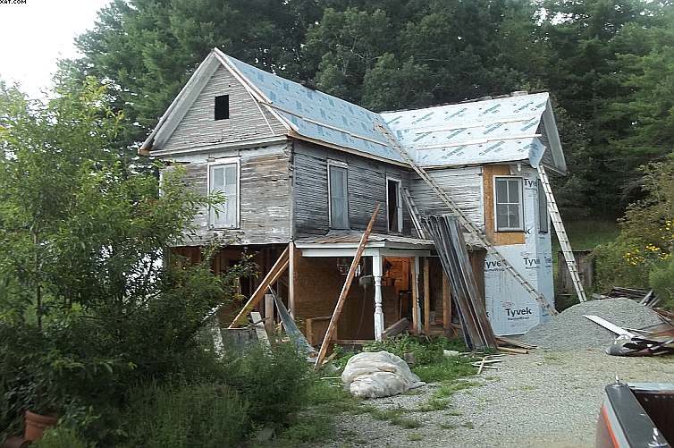

Last 2 shots are at lunch first, metal is off exposing the oak skip sheathing. By the end of the day we covered that with 5/8 osb and then Titanium synthetic tarpaper
