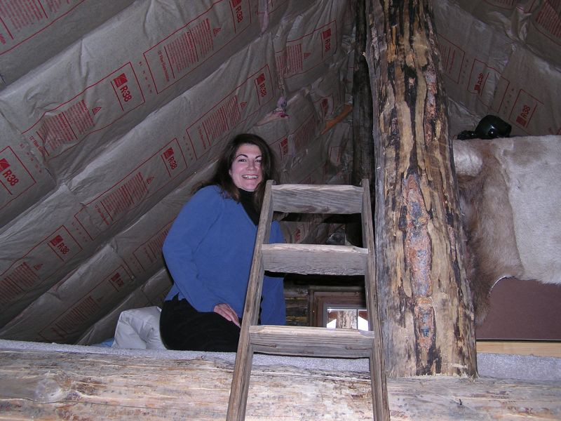

  We have a loft in 1/2 of our 24 x 14 log cabin. If you have a small cabin like this then the folks hanging with you are good friends and family most likely. You kind of expect close quarters with a small cabin.
  We access ours via an old ladder from a law library. It works well The only time we spend in the "loft" is when we are getting dressed/undressed or sleeping, so it really isn't a high traffic area. Our roof has a 12:12 pitch and I'm just under 6' 3" tall and don't have any issues using the space. We place our gear bags closer to the outside edges where the roof pitch creates a tight space and have our bed situated to the other side with our feet towards the lower roof line and our heads situated towards the middle of the room. We have a few tables, trunks and chairs up there and the space works really well. We put nearly new carpeting salvaged from a friends home with a carpet pad over the OSB floor.
  In the winter with the wood stove cranked we end up sleeping sans clothes and covers with the window open- then cover up and/or close the window in the middle of the night once things cool down.
  We put a smaller loft towards the front of the cabin (about 4' wide) which we use as storage and overflow sleeping area.
  Overall, I love the loft spaces and keeping the middle portion of the front room open to the ceiling really creates a nice space.  front loft
  |   rear loft
  |   rear loft w/insulation installed

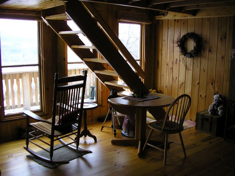

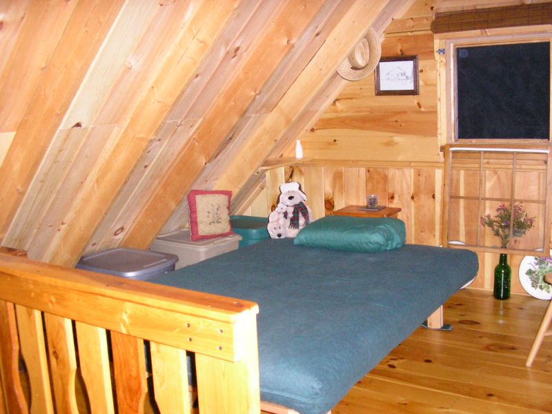

# Posted: 18 Jan 2011 07:41pm
  I have a loft in my 16+20 and enjoy having the extra room and that's the sleeping area. Noise is not an issue as it's only two of us. With windows at both ends and windows or a door open downstairs I get a good flow of air in the summer and it is fine in the winter.   I debated a ladder or stairs and went stairs , I lost  some space   but it sure makes it easy going up and down with these older legs.
elkdiebymybow
# Posted: 19 Jan 2011 12:00am
  Hill top-
  Sweet place!  My ladder does make me nervous, at 6' 3 and 225 lbs I have concern that one day my little whimpy ladder might fail.  I'm sure a stair upgrade is in my future!  Your place looks great.  I'm thinking a nice gin and tonic and that rocking chair could really be relaxing.  Thanks for sharing some pictures.
