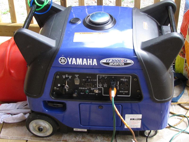

 So right now, I pull out the genie when I arrive and basically have it under a supported tarp if it begins to rain. I'm wanting to build a more permanent generator shed that also allows for the airflow required to run.
 What have folks built?
