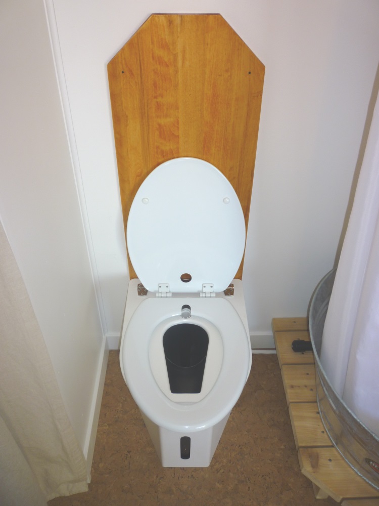

Why not just get a urine separating composting toilet? I have been using a C-Head composting toilet with their optional External Urine Diverting (EUD) accessory at my cabin for the past year and really like it. In my opinion this is the best of both worlds. I divert the urine to a greywater drywell which both reduces the odor, and the amount of absorbent I need to add to the composting pail.
My C-Head is also one of the more attractive composting toilets I have seen - looking very much like a real toilet. It also has a neat feature in that the EUD can be removed and replaced with a 1 gallon milk jug to collect the urine. Diverting urine to a greywater drywell would probably be frowned upon in my state, so I did want to have that option in case I ever get in trouble for doing it.
C-Head Composting Toilets

Glad I could help. I should have been clearer in my earlier post in that the C-Head is not a traditional composting toilet. It's more of a moldering toilet where it stores the solid waste until it is transferred to an outside composting bin. It's similar to the Loveable Loo in this way, but it looks and feels more like a real toilet, separates urine, is easier to clean and sterilize, and doesn't cost that much more (the Loveable Loo costs $400 now).
When I started researching composting toilets I quickly realized that I didn't want my composting to occur inside the toilet AND inside my cabin. First off, this would require either a very large interior bin under the toilet or under the cabin. This either makes using the toilet clumsy, or requires a complicated install.
Second, it takes a long time for waste to compost into a safe material. Just a single dump into already composted material resets the composting clock. This usually means having TWO composting bins to swap so one of them can sit undisturbed for the required amount of time to compost. It's just easier to have an outdoor composting pile to empty everything into when the container gets full, or just at the end of each weekend visit.
Third, I really don't want to take the chance that flies, or any other insect, could reproduce in my cabin for weeks at a time when I'm not there. I like being able to empty the toilet bucket, disinfect it, and close everything up not having to worry about it. My cabin is just a weekend getaway at this point in my life, so I'm not there enough to babysit an in-place composting toilet.
