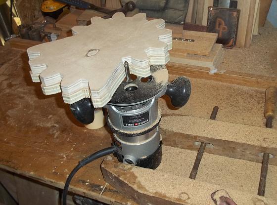

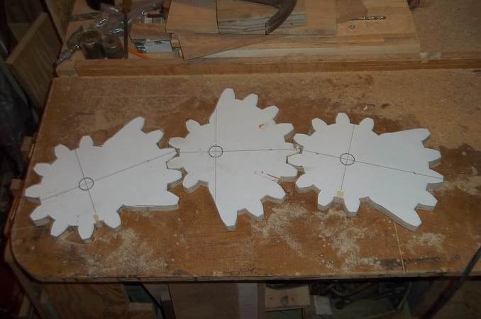

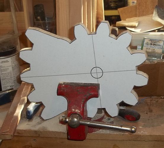

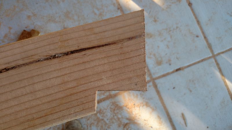

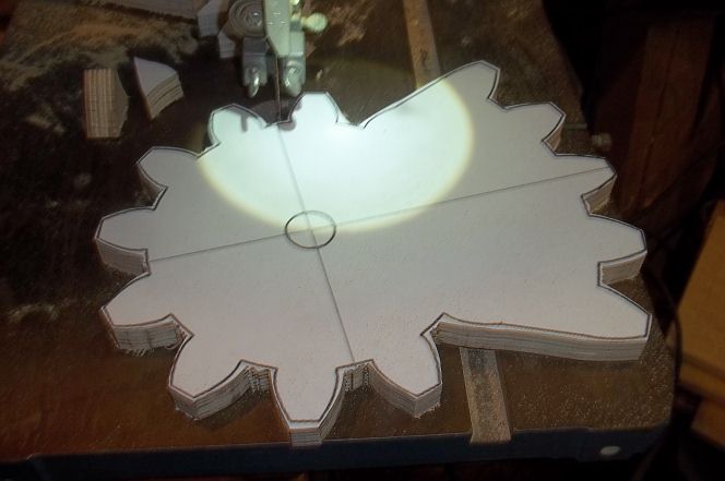

I got drafted for an explorer project and played in the shop today with bandsaw and router, thought it might be of interest.
1st shot is a bandsawn pattern. I cut out one of the gears carefully and then sanded to the line making a part that will also serve as a pattern
2nd pic is the next part rough trimmed just a little outside of the line
3rd I attached the pattern to the rough trimmed part and used a laminate trim bit with a bottom bearing the same diameter as the bit. By running the bearing on the pattern it duplicates the pattern. The pattern took over an hour, the duplicates took much less time. If you can figure out how to jig it, a router can do just about anything.
4th voila. I repeated that again for a gear train on the opposite side of the project.
Bearing-over bits with a top mounted bearing are also available if you need to plunge or work from both sides such as the rafter tails, usually in 1/2" diameter. gearpat2.jpg

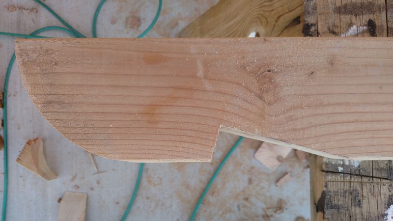

# Posted: 12 Feb 2016 09:43am

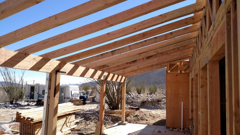

Thanks Don, looks great! I ended up going with a bandsaw, Milwaukee to be exact. Like you say, making the jig takes a while, the cuts are then easy..... Curved end and front birdsmouth
|  Seat cut
|  Rafters up
