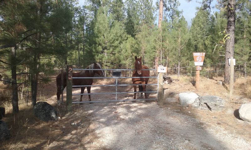

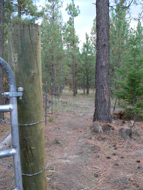

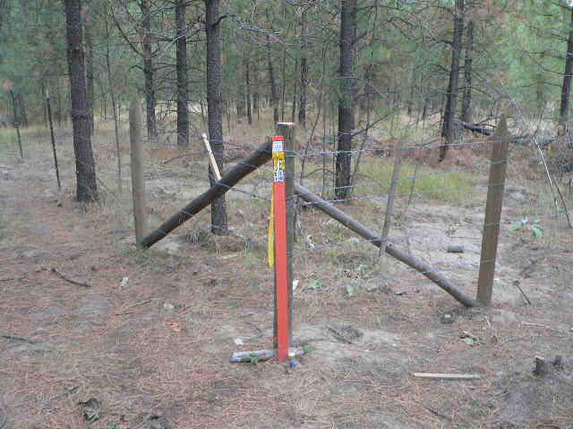

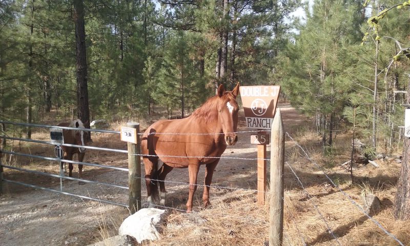

Depends on how high you want it. Wildlife passes right through mine or over it with ease. Its 4 feet high, 4 wires at 12" apart each run. It does keep out free ranging cattle, leaves lots of vegetation behind it for deer
I used wooden post, large round treated ones in corners and steel post every 12 feet apart along the runs. So far, its being used to hold horse who's pasture land was damaged and fence damaged by last summers wildfires. They had no place to go and no grazing.
Cedar post break easily, rot in time and you will have lots of work ahead of you. Are you doing it for the nostalgia? Just a short section, I would say that would be OK. Or do you want to keep in or out, some livestock?
Barbed wire fencing is spendy. I have $7300 in mine 20 acres (labor was 1.25 per foot, that is cheap, usually 2.50 per foot). That is only 3/4 mile around. I will do my other 20 acres next summer. P1020408.JPG

toyota_mdt_tech >>> looks good! Yes mine would be 4 foot or less. I have not seen where it has been a problem to wildlife or I wouldn't do it. I would have access to all the used power poles I wanted for corners and such. The posts inline I think I will use these old cedars keep the look like it was 100 years ago. I'm really not trying to keep livestock out or in. A few winters ago I had a couple of steers that wandered off of a ranchers place and they spent the winter on mine. The guy couldn't find them till late spring. Lol
