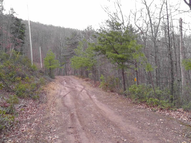

I need to plan on putting gravel down on my bare dirt driveway and spots long a dirt road. How thick, layers, and what size? As an experiment last year, I took a backhoe with some two inch rock from my property and put it in a mud hole. It sank out of sight after a few months. Anyone have experience with graveling difficult areas?

Dave, a drainage ditch or swale on the hill side of the road should be added and maintained. The road should also be sloped to drain into the ditch on the hill side of the road. Draining across the road to the down hill side would eventually cause erosion and eat away at your road.
I would also use large rock for the ditch in steep areas and transition areas. The goal is to move the water away from the road but to do so in a controlled way that reduces or slows erosion.
Once the roadway is dry the mud will firm up and quit swallowing your gravel. Vegetation in the ditch or swale will slowdown theenergy of the water flow. It is a good thing as long as it slows the water without stopping the flow.
Your photo shows a swale on the uphill side with the exception of the corner. There it looks like water is entering the roadway and more than likelytbat is where you are having issues?

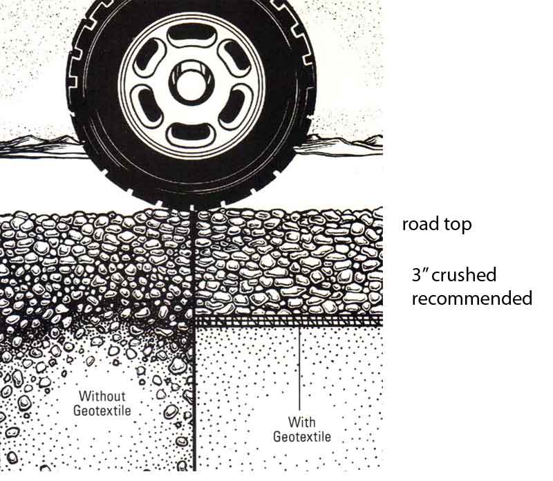

I built a 1000' road on soft farm soil. Doing research I found a study done by a mid-west university (minnesota?). anyway, here's their formula
remove green/live top layer (I removed 6" turf)
then
Geotextile + 3-4" layer 3" crushed + 1.5" road topper
= 30 year road
Mine's at 5 years and it's in the same condition as new.
