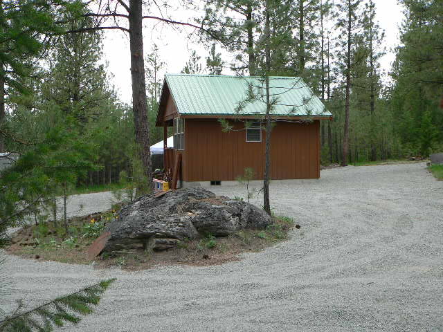

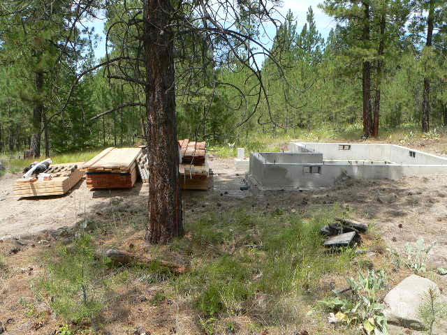

# Posted: 11 Jan 2017 11:42pm - Edited by: toyota_mdt_tech
Quoting: Shadyacres Did you take any pics of your space. I don't remember seeing it in your thread. Thanks
Shadyacres
# Posted: 16 Jan 2017 09:06am
Wow Toyota you certainly didn't scimp on the stone. No mud in sight. I like
