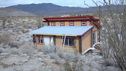

Quoting: MtnDon Is the present CC large enough to handle more panels? Is the present battery capacity large enough to cover some cloudy days? Or can the storage be expanded?
Well good news I guess is that there is no Solar system, it's going in next fall. The roof the panels are going on is south -facing, 12 x 24 ft and there are maybe 10 cloudy days per year where I am.. All that the solar will run (besides the fridge) would be lights, music, fans, TV and coffee maker. I have no clue how many panels or batteries I will need right now, any help appreciated on that. I used your old PV spreadsheet a few years ago and it came up with 4 panels as I recall, but that was then. Julie2Oregon - Good idea, but I think we would prefer the look (and size) of a unit made for a house, I could call around and see what I find, I guess. Anyways thank you! Roof where solar panels will go
