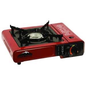

I picked up a single burner very similar to this for real cheap. It takes the aerosol size butane canisters, but I am wondering if it'd be worth it to convert to propane. I could then run off my grill size tank at camp for outdoor cooking.
Operating under the assumption that I can use propane as a substitute fuel is there a simple attachment available to convert the aerosol fitting in this unit for propane?

air orifice is a different size for propane, butune, iso-butane.
Not impossible but not really recommended.

Yeah, from what I see you can use propane but it will be less efficient in output. For my purposes I'll have to compare the output vs the comparative cost of butane canisters vs propane conversion.

There has to be a fitting available somewhere to convert that aerosol-compression butane fitting to propane.
Have you seen such a beast?

Plenty of small propane stoves are made- why bother converting a butane stove? Because you got it cheap (free)? Well, if one simple fitting will complete the conversion, might be a frugal choice.
I did a quick search for butane canister fittings and found various gadgets meant to attach to a butane canister so that it can be connected to other devices, but I did not see an adapter meant to fit into the existing stove fitting so that a different connection could be made.
I always thought that butane burned hotter than propane in a typical stove setup, along with having more btus per volume. How hot it burns is a function of the burn environment as much as it is the fuel type. But all things being equal in comparable stoves, I thought butane produced higher heat, maybe not.

Not necessarily "has to be" because the air mix may also have to be changed to achieve a proper burn/ I have not looked at butane vs propane, but do know that changing between propane and natural gas needs more than a simple mechanical change of the connection fitting.
