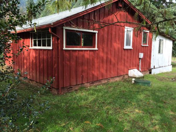

Here are some pics. The backside of the cabin shows most clearly the difference between the main cabin and the add-on. The other two pics are interior shots of the main cabin -- living room and bedroom.

I see five opening in the "cabinback" photo under the red board and bat siding. Looks like crawl space vents to me. Why would they be there if this was a concrete pad? The big turn off, run a way fast is the fact that the original cabin is painted red and they painted the unpermitted addition white. Two reason, this shows me they were not good builders and two, they could be University of Alabama fans, that Red and White and being an Auburn Grad, that is a definite no, no in this part of the world. you do not even talk to U of A people. Check out the football association of these people and run away if U of A fans, because it is not a good purchase. War Eagle!! most U of A fans are a little warped in the head, so if really interested, bldinsp needs to come check it out before any money exchanges hands. Best advice on this property ," move on folks, nothing to see here. "

Actually, these pics are mid-paint and I think the white is a primer. In other pics, the white isn't even finished. You're right about the vents. The listing said concrete foundation and I just assumed that meant slab. I didn't look carefully at the pics prior to here because they were small. They reposted bigger here, which is way cool!
