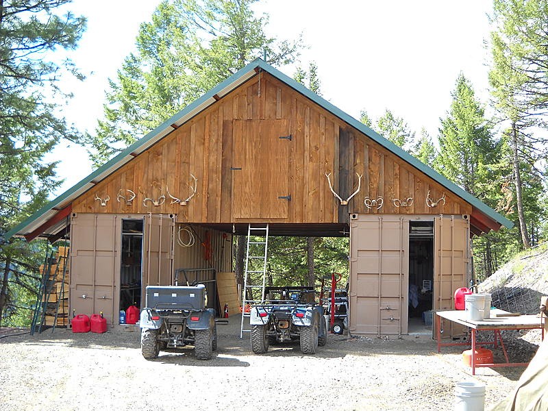

James, it was not cost effective for me. My cabin site is up on a mountain and too far from the closest port. I didn't want to be restricted by all the seven foot widths once walls were installed. I Googled Toronto Shipping Containers and there was a lot of info. Post pics of your project. Good Luck.

If you read it you will find that I do not regret building my container cabin at all. In fact, I would definitely do it again. The thing is, most people think it's easier and cheaper building with containers than traditional construction. I am here to tell you that it absolutely is not. My container cabin cost about $36,000 for 480 square feet (external). After building my cabin I ran the numbers and an identical sized traditional cabin would have only cost about $20,500.

Steve961's experience is quite instructive. Nice build, Steve.
Notice, the construction required building a foundation and roof, both very similar to a conventional build. So all that was saved was building the walls and floor. Walls are the cheapest and easiest part of conventional framing, usually go up in a day. You can build a lot of floor and walls for the cost of buying containers in good condition and having them delivered.
Steve's result achieves his purpose- that place won't get broken into. I hope the future does not require that we all have to build a Fort Knox to be safe and secure.

Thanks bldginsp, I appreciate the comments. You are right about the walls being the cheapest part of the build. I try to tell people that shipping containers are basically a very expensive form of siding - especially if you don't need the security.
One of the oddest things with most container builds, at least to me, is that they take a perfectly good container and then cut a lot of holes in it to put windows and doors. This destroys the two best features of containers - security and weather tightness. At the point you do this, you might as well just build with traditional materials and then side it with metal panels. You will get the low maintenance of steel with the low cost of traditional construction.
In regards to the plywood floors being treated, yes they are. Many builders replace them with new plywood. I encapsulated mine with epoxy and then added a subfloor on top as a physical barrier. I am comfortable with that decision, although I know others would not be.

You are absolutely right. If I didn't need the security for my cabin I would still have a container or two to store my tools, ATV's, etc. A great build I saw used two container spaced apart with a cabin/storage area built into the roof. This is probably the most practical way to use containers for most folks.

steve961 That is a great design. I really want that!!
