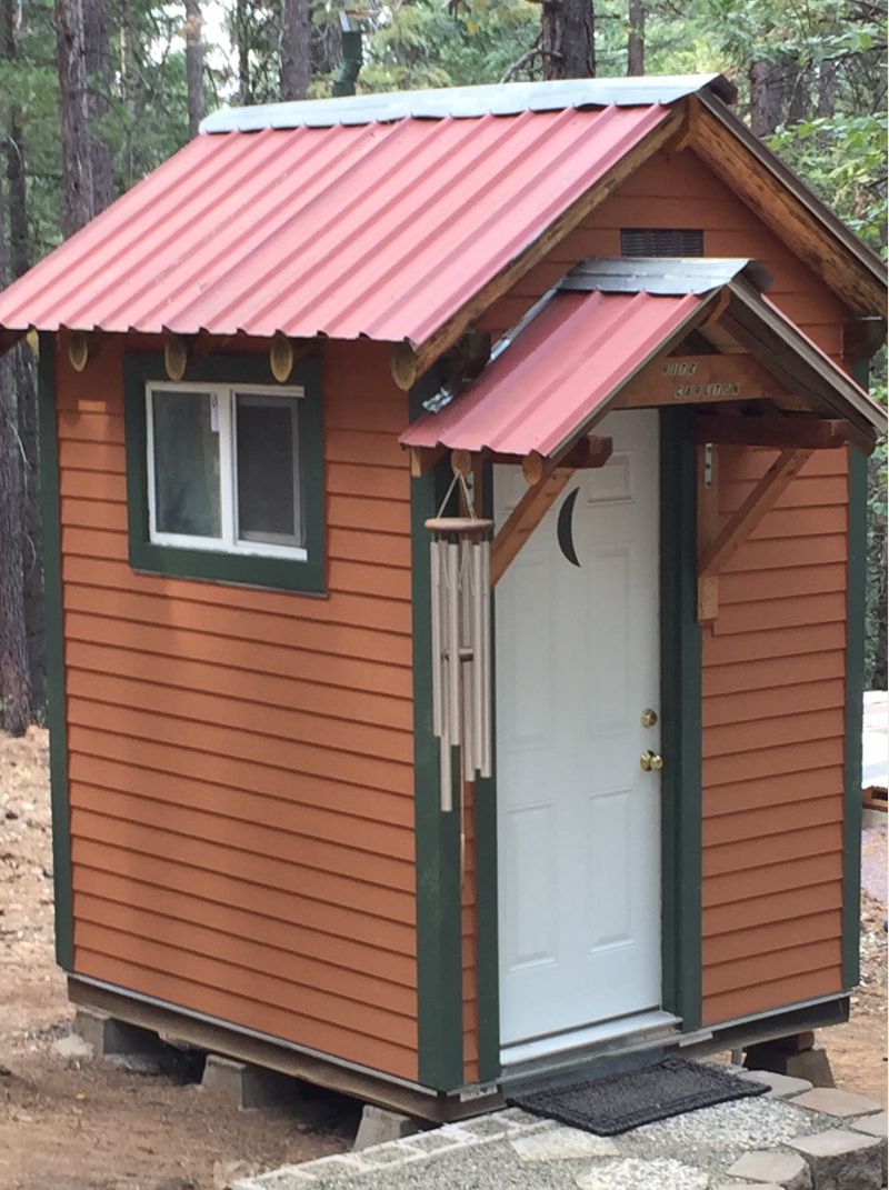

Stone or concrete stepping stones on gravel works pretty well. That's how I did the path and landing to my little bath house. So far so good.
