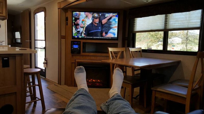

MtnDon - It's only money. LOL. The fireplace is more for 'ambience' than any real functional use. I just always thought that a cabin should have a fireplace. In retrospect, I probably shoulda just put in an electric one. My new camper came with an electric fireplace, and it does a very good job of simulating an actual fire. See attached pic.
But I am in it this far, and the excess heat is not a deal breaker. I'm just thinking it would be nice to light a fire on cool evenings to set the mood without roasting us out.
