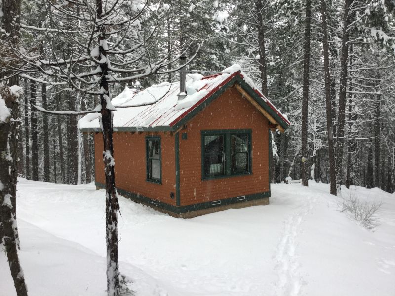

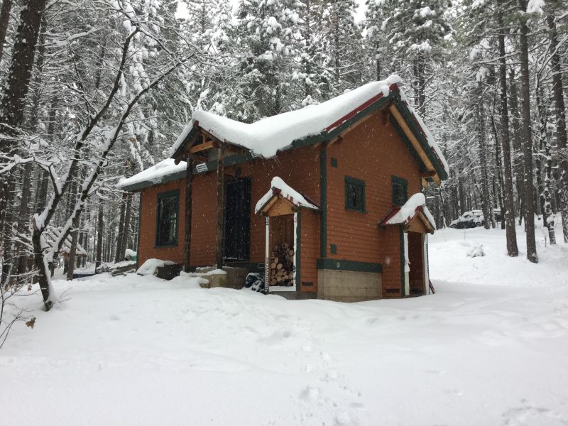

This is my cabins first winter, so I am trying to keep an eye on things. Is it better if the snow slides off, lessening the snow load? I'm thinking I may need snow shutters to protect my windows if the snow keeps sliding off and pileing up the side of the cabin. Should my overhangs have been bigger? Took these pics today, 2 days after snow totaling about a foot. Snow slides off an unheated cabin. Is this just because the dark roof was getting full sun? Could this cause a problem as winter progresses and more snow slides off, putting stress on side walls? . .

bldginsp ........"You'd have to get a lot of snow, though, for it to pile that high."................
Average annual snowfall 140".......

Kind of late now but with a 140" average, you should have made those eves stick out farther. It's interesting that the snow you show in your photos landed straight down from the edge. When ours goes, it has enough momentum coming off the roof that it lands several feet out from the edge. That, combined with a 2' overhang, and that our cabin is up off the ground, the snow never touches the walls.
